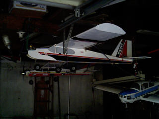

Just looked like a good place to throw in a photo of my LT-40. It has a GMS .40 on it with an 11X5 Prop.
