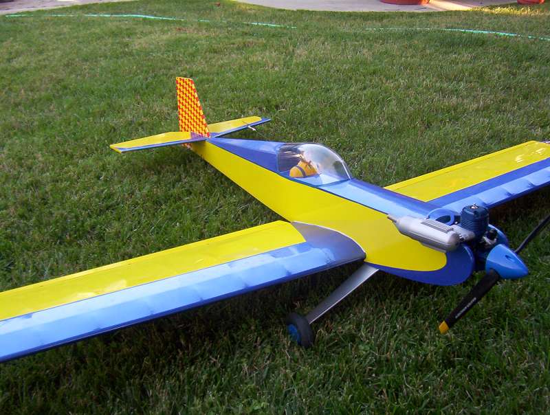

You will just keep falling in love with the 4*. Between my 4* and twist it's a toss up of which is my favorite.
I agree with the toeing in of the main gear to help the tracking problem
I have done the following to mine and knife edges and roll rate and all around general flight and feel characteristics have really improved
1. Add 2 1mm washers between the motor mount and the firewall (1 each per mounting bolt) on the left side to help with tracking and torque.
2. Seal all the aileron and rudder gaps, helped alot with the roll rate knife edges and general flight and feel of the plane. It makes all the surfaces much more effeicent.
3. I added 1/8x3/8 foam tape to the wing saddles and now my knife edges are straight as long as I keep about half throttle or more. Below half it just falls out of the knife edge.
4. Set book throws for your low rates and do your high rates at 125% with 40% expo on all surfaces on both rates. On low rates with the gaps seals roll rate went to about 2 per second and on high rates about 3 per second and in both modes they were much more axial.
Here is a link for sealing the gaps
http://www.rcuniverse.com/forum/m_11...tm.htm#1126912
Since this pic was taken I have tinted the canopy and added tweety bird for the pilot. Oh, I also turned the canopy around and cut it in half to make it more sleek looking
