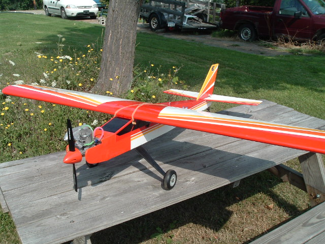

Finally finished the conversion from Trike to Dragger. I removed the dihedral from the wing, but it took 2 weeks with my schedule. I had to hacksaw the wing where I had epoxied it. Then took a piece of basswood and cut a rib to fit in the gap that was left when I flattened out the wing. I used a 60 size tail wheel because I wanted the largest practical diameter tire on the rear that I could get, since I fly off grass. I mounted 3 1/4" tires on the front. Still using the Evolution engine, after I replaced the bearings in it. Now I am using a Master Airscrew 11x5 prop. All this because I ripped the firewall out when the nosegear struck one of my runway markers, a gallon jug painted fluorescent, filled with water..... Now I just need a day to get out and fly it.

Looks great. Now it even looks like a real airplane. Thats a good way to learn more from your trainer.

Forward thinking, I had to add a "pad" to mount the tailwheel to , and had to beef up the belly with doubled up 3/16 ply to accept the main gear. The hardest part of the whole thing was the added Ultracote at the forward fuselage from where I had to repair the firewall, and at the top of the center of the wing, where I cut off the old covering to make the new center rib. Now I also hope that I put the main gear far enough forward so it won't tip over. I taxied it the other night, and even using full up elevator, in the rough grass,(not my runways) it wanted to nose over. That was before I had the wing finished.

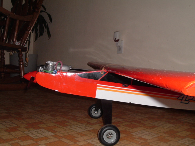

Here are some better pictures. You can really see the orange ultracote now where I patched the nose up, and the clearance beneath the tip of the prop. I didn't need to make it beautiful, I just want it to fly....

Well, get used to using both sticks at the same time. You must hold up elevator if you want to taxi. Period. After noseing over once, took it for a lap around the runway. Because of the setup of the tailwheel, it makes longer turns. Can correct that by remounting hole for pushrod closer to the wheel.
Takeoff was relatively uneventful, after gaining some speed, let go of the up elevator, the tail just pops up off the ground. As soon as flying speed was reached, the plane basically took off on its own, about 10 degree climb. This was at full throttle by then. Left bank at the end of the runway, now that was different. MUCH faster than before, but not wild, just rather quick. By the way, the wind was 15mph easily, not too gusty, but at the leading edge of a weather front. I could see right away that the plane just wasn't nearly affected by the wind as it used to be. I left in 1/2" of dihedryl on the wing. I would barely have attempted this with my Alpha before the modification. The 11x5 Master Airscrew did provide an increase in speed, evident even going into the wind, which had picked up some. Elevator and rudder response remained much as before, and with the throws left at near maximum from when I had decommisioned it as a trike, there were no surpises here. Basically, the aileron response is much increased, and the roll rate is increased from before. It behaves more like what I imagine a Sport plane is supposed to handle like, snappier. This was only in the first few minutes of flight. It required no trim to make it fly where I wanted it to. I wanted to land it in one piece, so I made about 8 passes lower and slower, 1 touch and go, and then brought it in. I was really worried that I would nose it over as it slowed down, but it didn't happen. Once I defueled it, got it back into the shop, I moved the main gear forward 1/2 the diameter of the front wheels. This is also coincidently the area that straddles the first bulkhead under the LE of the wing. I will try again tomorrow, or whenever I get a chance. So far, the move was a good use of the old trainer, looking to see what else I can squeeze out of it....

I put the Main gear forward 1/2 the diameter of the tires, that really helped the nose over problem. Still have to use both sticks... Drilled a new hole for the tailwheel pushrod about halfway to the pivot from where it was, and that tightened up the turning radius a bunch. It will turn in about 8 feet now. With the wind gusting to 17 - 20 mph, full throttle will cause some ballooning turning into the wind, I saw fair evidence the wind was blowing when I made my first bank at the end of the runway. No loss of altitude, but the wind pushed it good. Had to give some up elevator going with the wind, it started to sink, but nothing alarming. I may try an 11x6 or 7 prop just to see what it does..Got rained off the field.

It does look good, but the mains are to far back. That's why it wants to nose over. []
In general you want the mains around 1 inch in front of the leading edge. When I say the "mains", I am talking about the axle being 1 inch in front. I did that with my LT-40 and have no problems with it wanting to nose over and ground handling is superb. I did use the same tailwheel you have and added a carbon control rod connected to the opposite side of the rudder servo from where the rudder is connected and exiting the fuselage on the opposite side of the fuse from where the control horn connection is on the rudder. Took about 3 hours to complete and works like a champ. I think the total cost for the control rod and tailwheel were around 20 dollars. Nylon rods work well and are cheaper but tend to change trim settings based on temp and humidity.

The pictures that I posted were pre-moving the gear forward. I moved them up 1/2 the diameter of the tires, no more noseovers. I used a steel pushrod for the tailwheel, its what I had around. Everything works fine now... It is familiar, but comes around a lot faster than it used to. I think I had best watch how hard I turn it, I have gotten kind of mean with it lately.
