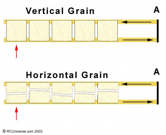

Ok, one last shot at why vertical is better (don't take this too seriously, ok?)
If the forces are at an angle, and we all agree that balsa failes more easily along the grain than cross-grain, then any failure in the web should show up at a grain-wise crack. If the web is veritcal, the crack has little effect, since both ends are still glued to the spars. If the web is horizontal, even a small crack disconnects the top and bottom spars
I'm only talking about cases where the sw is individual sheets between the ribs, not the one long sheet between the spars.

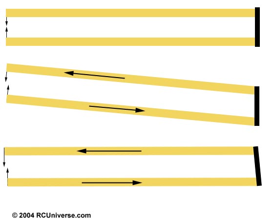

ORIGINAL: Chuckr53-RCU
I'm just curious...why are they called "shear" webs? I thought the main goal of the shear web was to restrict the opposing lateral movements of the top and bottom spars under stress to add stiffness to the wing, to resist the bending of the wing when subjected to positive or negative G's.
That's what I thought.
You're right. When airpressure tries to lift the wing, it is "Held down" in the center by the weight of the Fuse. If all you had were two spars (pivoted in the center of the Fuse) and you lifted them, they would "Shear" against each other.
To save a few thousand words, refer to the pictures below:
ID:	173209   Click image for larger version

ORIGINAL: Rodney
Brownknows, it makes no difference which way the grain goes as the stress is at a 45 degree angle to the span and switches 90 degrees as you change from positive G's to negative G's. If you don't believe this just check out any strength and materials book on beam design. It is usually easier to put them in with the grain vertical and will work just fine in that manner and is a good compromise; however if the grain ran spanwise they will be just as strong when it comes to resisting G loads.
From a structural engineering point of view I don't know which way is best, However, That being said I can speak from some 1st hand experience. I acquired a used Hobbico superstar (pre Monokote) which had loose sagging covering. Over the winter I decided to recover it. After removing the old covering I noticed that on both ends of the wing the shear webs were split on the inner 3 or 4 bays. You guessed it, the grain ran parallel to the spars. There was no obvious signs of a crash which required any repair so I assume that it had lived an easy life up to that point.
I have always placed the shear web grain perpendicular to the spars and will continue to do so.

MinnFlyer, You are correct for a simple shearing action typical in building structures but by far are NOT all the loads on an aircraft wing. An aircraft wing is much more dynamic than this. Your picture does explain why they're called shear webs but in no way accuratly shows all the forces in a wing. This could go on for pages and pages to explain it but the greatest amount of shearing happens closer to the mid way between the root and tip. It happens towards the tip as well but stop increasing again as you reach the tip. NO shearing happens (if the load is "perfectly" equal on each side) at the wing root. Even if the load is not prefectly equal there will be a point close to the center where shearing does not oocure.
I know you guys are smart and I don't mean to insult anybody but I don't believe there's any way to explain this in layman's terms. Aircraft wing forces are way to dynamic.
Old 09-14-2004 | 12:49 PM
  #37
MinnFlyer's Avatar
Posts: 28,519
Received 9 Likes on 9 Posts
From: Willmar, MN
Default RE: "Shear Web" Question?
Mike, I realize that there is much more that comes into play here, but as you said, this is why they're called "Shear" webs.

Maybe this is why vertical grain is used:
I think we all agree that the shear force is at 45 degrees to the wing span. However, this force can be broken down into a spanwise force and a vertical force. With the diagonal force broken into components you can see how the different grain orientations perform.
Lets look at vertical grain shear webs: Here the vertical force, tension or compression, is resisted by the vertical grain. All is OK. The spanwise force, T or C, is resisted across the grain. This is not an ideal condition. However the wood only spans from chord to chord so this isn't so much of an issue.
Now for spanwise shear webs: The spanwise component is resisted along the grain and all is good. The vertical componenet is resisted across the grain, bad things might happen here. The web spans from rib to rib, a much longer distance than spar to spar. Also, the rib grain is oriented in the same direction as the shearweb, so this doesn't really help hold things together either. I can see where the shear web could split or buckle under load easier with the grain running in this direction.
