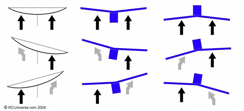

Try the following:
Get your plane flying up-right, straight and level using your trim settings to get it flying "hands-off".
Now do the same thing with the plane inverted. In theory you should only have to adjust the elevator trim.
The dihedral "self-leveling" stability is nothing like the forces applied by ailerons, etc. You will find that the plane "falls out" to one side of inverted, but will remoan very stable upright.
gus

Did you ever fly a Kite?
Remember how you would tie a string across the back to "Bow" the surface?
That's dihedral.
Without that bow, the kite would wobble for a bit, then turn sideways into the wind and fall. But because of the bow, if one side turns into the wind more than the other, it gets a more direct hit from the wind.
In the illustration below, you can see how the wind affects the surface of a Kite. Next you can see how this same priciple is applied to a wing.
And finally, you can see how dihedral will help an inverted wing right itself.
