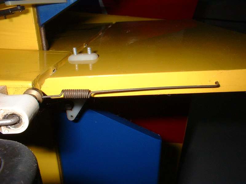

Can someone show me a close up picture of a sullivan tail wheel installation? Have one for a four star and not sure how the wire gets installed into the rudder. I know it's bent up and then is it glued in? How far does it hang out below the rudder, and where is the best location for the spring? Do you put some covering over it? I think a picture would be the best if someone can help. Thanks.

It is glued into the rudder. Epoxy is best.
I have mine right up against the rudder and also epoxied to it.
I put the spring into the rudder about 2 inches from the leading on the underside. Use the heavier of the 2 springs they give you.
You can put some covering over it if you want to but that is personal preference. (I didn't)

Here you go,
Altough the focus was not on the gear in that photo it shows.

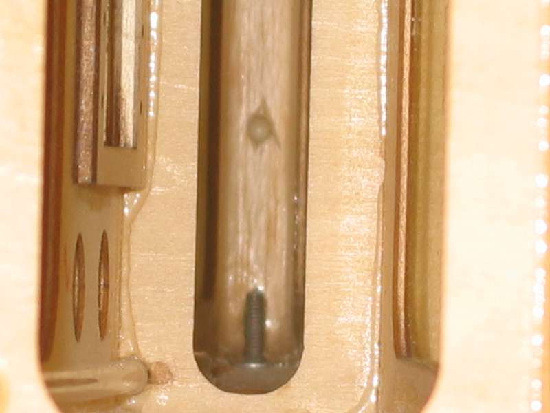

Thanks Cobra for the photo. Here is another photo of how the tail was attached.
1st = Tail wheel assembly
2nd = Longer bolts used to reach the blind nuts
3rd = Blind nut location
4th = Tail wheel bolt looking through fuse

Steve, Its quite easy. Just bend the spring/wire about 1/2" or so from the end at a
90 degree angle up, (toward the rudder). Then press this section into the
rudder wherever it lines up. A drop of thin ca at that point will further secure the wire in the rudder. When the rudder turns the tailwheel will follow.
You can also use a small strap of some kind to strap the spring/wire end to
the bottom of the rudder instead of bending it if you so choose. It is quite
easy and once you have done it you will see. Good luck.

Thanks for all your replies. I thought that was how you did it, but just wanted to be sure.[8D] do most of you glue it down the length of the rudder like the first picture or have it hanging below the rudder like the last picture?

I will try to answer. The white plastic assembly that holds everything is bolted to the bottom of the fuselage with two 4-40 bolts into blind nuts. Then the steering spring ends in a long straight wire that is simply poked up into the bottom of the rudder. I push the straight wire (with canopy glue on it) in until the spring is paraell to the bottom of the rudder. Does that help?? [8D]

On the three I have, I glued the long side of the spring to the bottom of the rudder. On the others that I have seen they are either glued/clamped to the rudder.

I have 3 of the Sullivan units in service. On all 3 I reinforced the area to mount them with 1/8 ply and used four #2 sheet metal screws to hold the bracket on. The wire is glue in with ca only where it goes into the hole. The horizontal section is down about 1/8-3/16 and not glued to the bottom of the rudder. I've used the light spring on all of them. This lessens the strain on the rudder servo and turns the model fine when the plane is moving.
