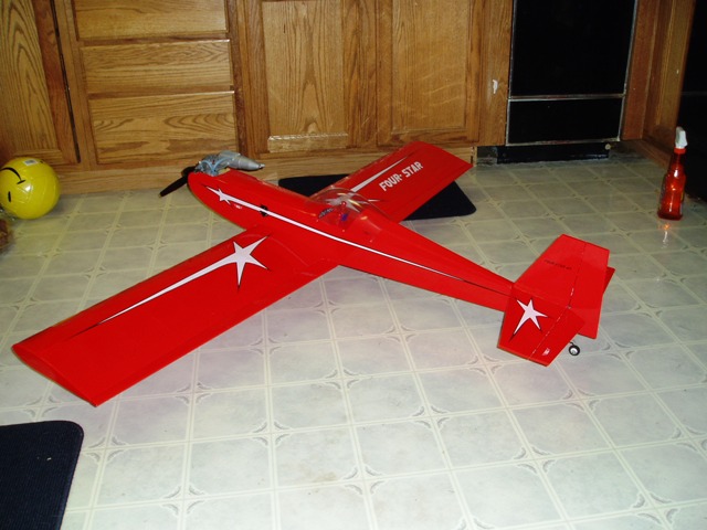

Just thought I'd show everyone. I'm moving up from a Nexstar. Can't wait to get it out to the field!

Great job bodypilot!! Have fun flying it!!

ORIGINAL: bodypilot
Thanks! Hopefully after the first flight I'll still have something other than those photos. [X(]
I also hope it goes well for you. Thats a pretty plane and
it flies as good as it looks. You will be happy with it. The 4*
is a good first low wing plane by any means.

I think you'll do fine with it too. Nice looking plane, and they really do fly pretty easily.
What engine did you use?

Thanks guys. I put a Thunder Tiger .46 Pro in it. That should scoot her around pretty good.

Body Pilot, you will find your combination of plane and engine to be about perfect. This plane is a Bruce Tharpe design back when he worked at SIG, and one of he things that make this an exceptional design is the very broad flight envelope it has. Sure, it will scoot along with the other planes, however, it also has terrific slow flight ability. If you haven't done much slow flight you have a real treat in store. 3D planes do slow flight by flying on the prop (so does that then become a rotary wing - don't get me started), but this plane will fly slow on the wing. Suggest a 11X6 APC prop, then, if you want slower speed with higher torque performance, go to a lower pitch like 11.5X4. Experiment, see what you like best

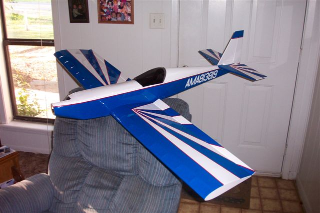

Looks great! I really like those wheel pants too. But like Glen said, if you are flying off of a grass field, best bet is to remove them. I'm just finishing up my 4*40 kit. I made a few changes to mine however.

My plane was very nose heavy with the TT Pro .46. I just had to put the battery pack behind the servo tray. Balanced out just about perfect like that. I did re-fuelproof everything also.
We've got a pretty nice runway at our field. So MOST of the time i'll be landing pavement.
