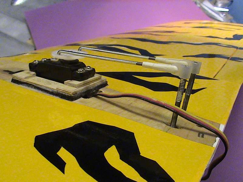

I'm having trouble with the hookup of my ailerons on my 4*40. When I go to full deflection the clevis on the servo bends such that it pops out of locked. They are the plastic clevis. Is it better to go with a metal one that I can lock into place better or is a ball link a better way to go?

It sounds as though something is binding. Is this a 4* with a single servo in the middle of the wing or 2 servos, one for each aileron?
Also, you want to make sure you use a very small peice of fuel tubing over the clevis to help keep it locked.
Ball links are the way to go but plastic clevises should work well on that plane

Single servo in the middle. What happens is the aileron rod horn gets low compared to the servo arm and the bending is taken out by the clevis at the servo arm and it pops undone when at full deflection. I don't want to count of the fuel tubing to keep clevis closed, it should just be a backup. I want the clevis to stay together on its own.

It sounds as though you may have the control horn on the aileron rod (torque rod) turned down to low. If that is the case then turn it back up near the top of the threaded portion of the rod and use a longer servo arm ( 1 inch each side of the screw hole ).
The other thing you can do is reverse the rod connection at the servo arm. I did Z-bends and came in under the arm instead of on top. With the longer arm, z-bend underneath the arm and the control horns about 1/2 inch down on the torque rods. I was able to get all the throw the ailerons would give me.
Another thought just came to mind. Is it possible you have the control rod turned into the clevis to far that the rod hits the control horn when you get to a certain deflection?

The ailerons are not binding. I like bubbas Idea with the z-bend under the servo arm. I might also try to readjust the angle that the clevis enters the arm. I already put the control horn about 3/8" from the top. Thanks for all the input

Hi!
Here are some pictures of a servo/aileron set-up in one of my airplanes.
You should always strive for to have as long control arms as possible and as short servo arm as possible, thats the rule.
