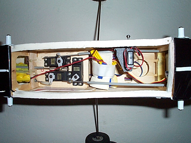

I just got my AFR avistar in the mail, and I have started working on it. I am having a hard time seeing the pictures clear in the manual because they are black and white. This thing is way more complicated to put together then I thought even with the manual. I need a favor please. Does anybody have any close up pictures of a trainers inside part. Like where all there servos are placed and the reciever and the switch. and the motor. And what there control horns look like. I am confused and I am scared to mess it up because it cost alot of money.

I noticed in the pic above, that the control rods where not bent at a 90 degree angle like it says to do in the manual, is there a reason for that and does my avistar come with those hook ups too so I can just stick them in those things instead of bending them at 90 degree angles. All so, how do you adjust throw, do you do it with the radio or manually. I have alot of questions and I am at work and it is driving me crazy I cannot be working on it now. I know I could be using the Search tool to find some answers, but I am and work and do not have that much time, I figured asking questions would be faster.
StoneDeaf, buy a 12" extension to leave permanently plugged into the reciever. The "Z' bends described in the manual are safer than the quick-connects shown in the photo. The servo arm can be taken off the servo to stab the control rod. When you get to the point in the assembly when it's time to adjust the control surfaces, do them one at a time. Without any of the control rods or cables hooked up to the servos (pull the arms off the servos), but connected to the servo arms, turn on the tx and the rx. The servos will center themselves. Now rotate the servo arm until the control surfaces are at neutral and find the nearest place they will go back on the servo. They can be fine tuned by screwing in or out the clevises. The different holes in the control horns at the rudder, elevator, aileron and throttle and on the servo arms will provide the proper throw. It would be much better to find someone at your local flying field to help you with this. For every question answered, there will be ten more. There should be someone at the field willing to help.

Hey StoneDeaf.. I used the supplied easy links on the elevator and
aileron which has the 90 bend, on the rest of the servos I used E/Z
push rod connectors. A lot of people do not like these connectors but
for a trainer I see no problems you just have to give them a once
over every now and then. I have well over 150 flights on this setup
with not a bit of problem. As it has been said above you just need a
6" extension plugged into the rec. and that will be the only one you will
will be taking apart on the servo side. If you look at the tank side of
the pic you can see the female side of the extension which plugs into
the aileron servo in the wing.. Keep your rec. ant. as far away from
the rods and servo wires as possible to prevent interference. Another
good tip is to either used a cable for the throttle or as I did mine, I cut
the rod in the middle and added nylon tubing between the cut halfs with
in the rod housing. This will give some "give" incase of nose-in(crash)
which a lot of trainers seem to do and can save a servo etc.. I never
had a chance to test mine:-) As said above the best bet is get local help
from the club... Keep us updated and have fun!!
