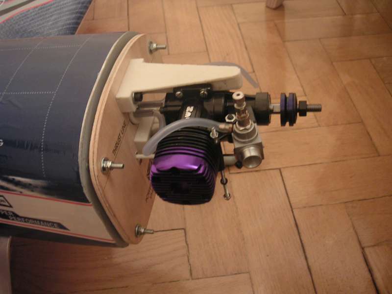

Hi
You wont beleve it but im almost finished my new Vmar, (it took me only 3hours!!!)
Im just waiting for bits + bobs and my brand new Jen 56!
Question:
Look at the first picture.
Do i need that padding between the wings? Instructions dont say anything.
I will have a Jen 56 in this, now i have Futaba S148's in rudder throttle ele. and
S3003's in wings. Should i change my ele servos on S3004 or S3001?

when i put that padding on, there is a small gap between the wing and the fuse.

I would probably say No to the padding, its probably just thier to proctect the plane in transport............ if the instructions dont say anything dont use it............
I fly alot of 3D planes with plug in wings and NONE of them have any kind of padding inbetween..... its not a great idea to have a gap inbetween the wings if u dont want them falling off in flight...........
As to the servo's the ones u have seem fine

Had my Vmar 330L about 3 weeks now. Powerwed with OS46FX and JR radio Flys Great. The covering is a bit poor needed reshrinking after the first day in the sun. I fitted the wing pads and looks like they are there to take up any difference in wing to fuse fitment. You can land as any other aircraft like any other, just keep the speed up at first untill you get used too it or it will tip stall.The pink sky pattern under the wings and tail is very easy to see in the sky. Good luck.

I have decided not to use the wings pads!, as for the covering that is no problem for me...i live in London!!.

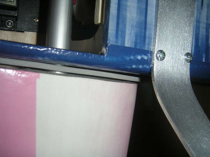

The left wing panel was not a flush fit with the fuse 1 deg out, but can be taken up with foam. Had to reset Incidence of right wing out by 3deg.

Measure the depth of the holes in the wing panels for the alu joiners before you cut them. Remember the longer joiner goes to the rear. the 1deg out was at the front of the wing. I have heard that they may have been built by deaf and blind builders as the quality varies greatly from model to model. As with the covering that is another story. I am thinking of recovering mine from scratch as it has started lifting again.

Ghost: on a second look, its only the left wing i have attached pics
is this what happened to you???? i need to fix this by saturday, so all you
did was put more foam inbetween the wings and fuse?
