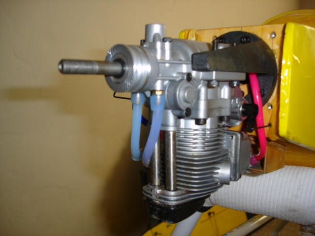

can you post a picture of the plane with engine installed? always wanted the WM MM but couldn't figure out how to get a clean engine install in the narrow cowl!

Here's a few pics of my WM Midget Mustang.

That's a great point, DadsToysBG - the fact the Y.S. is pumped means that you don't even have to run any muffler because the tank pressure isn't dependent on it. You can run it with only the header if you want!!!
Jmoga - that is a nice install... I guess 4 stroke inverted is the only way to go for the WM MM!
