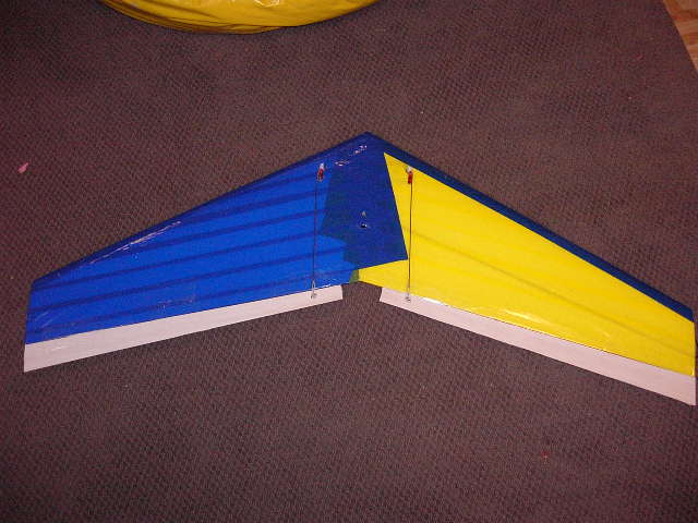

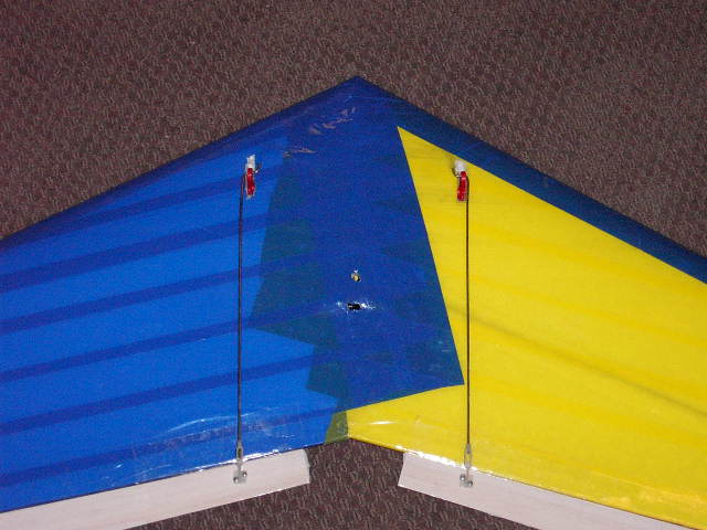

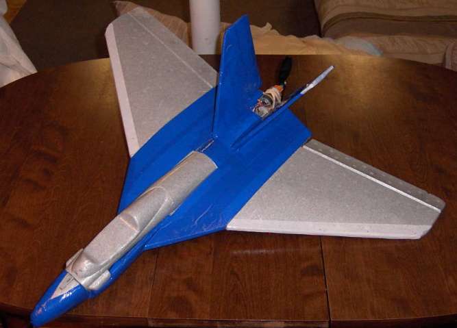

Elevons on a flying wing and a delta wing. These are the two most common applications.
