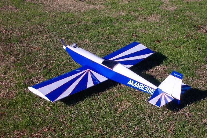

I do the opposite, I make the bottom a solid color and the top different. usually something directional so that it is easy to see at a glance which direction the plane is pointing
