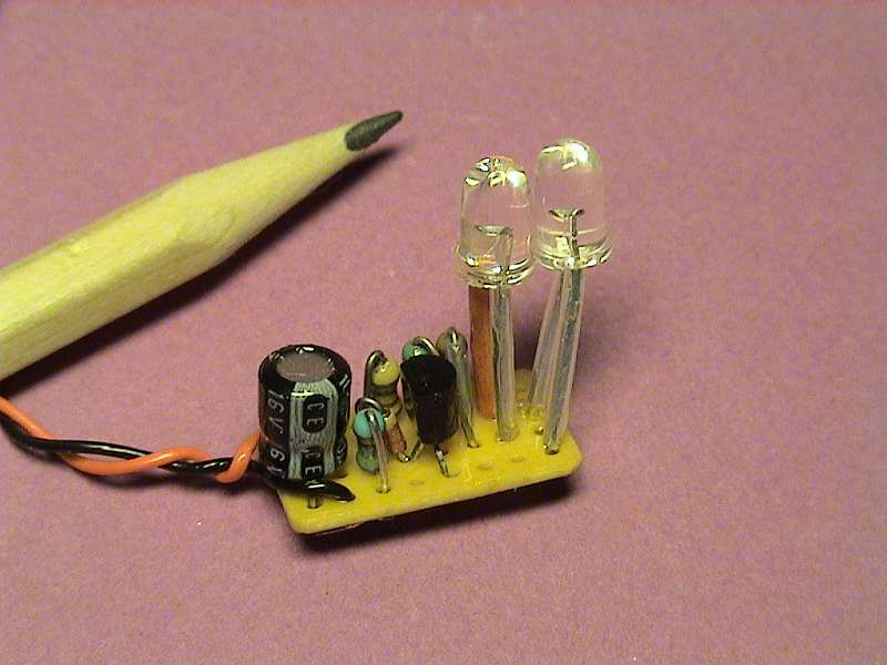

Sounds as a battery problem to me. What did your battery checker say? You do use a battery checker onboard your airplane don't you?!
As for batteries... Don't use Nicad batteries, 2300mAh Nickel metall hydrid cells are available at the same weight and size as those old 500-800mAh Nicads.
Regards!
Jan K
Sweden
