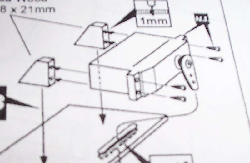

Does the brass sleeve go up or down ?
Installing for the aileron.
I think it goes on top or do I really need
to put them in the servo ?
Thanks,,,

They are best used to maintain some amount of cushion effect in the rubber. If you leave them out, you can tighten the screws down to a point where the rubber has no vibration dampening effect. My experience with Futaba servos has been to install them flange down, the shoulder of the screw comes down on the tube end of the bushing and forms a grommet to hold the rubber tight, yet allow it to dampen vibration.
They also help maintain grip on the servo. This will keep your servo from becoming detached in flight! A most challenging predicement!

same here... futaba (and most others) flange on the bottom. I recently got a bunch of blue bird servos, and they come with 8 flanges per servo, took a little bit to realize one set is smaller and designed to fit inside the other, pretty nice design! You get lots of cushioning and good surfaces for the screw head.

I studied this a bit.
I feel that the brass bushing should be installed from the bottom. This will provide a wider surface against the wood. If installed with the flange toward the screw, the thinwall of the brass will cut right into the wood, eventually becoming loose and rattling. With the flange against the wood, the screw head is against the thinwall side and a sort of captive spool is created. The screw head will not be bothered by the thin wall edge. The brass bushing also keeps the rubber grommet snug in the servo flange.

WOW! You had to wait a whole 7 minutes for a reply. This isn't a chat room Radcom.
By the way, always grommet end down, or as Sooner and Tim pointed out, the thin wall will cut into the wood eliminated the grommets, and the rubber's purpose.

In your picture you have them upside down. You want the wide flange at the bottom.
