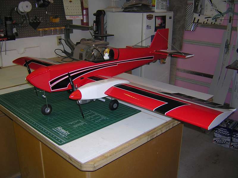

Im setting up flaperons on my four star and im not sure how much throw they should have. I need to know how much throw the flaps should have and how much the elevator should have when i turn the flaps on.

I would start with the flaps moving no more than 50% of the aileron throw. I also leave the elevator out of the mix until I get the flaps working as I like them. Then I start adding elevator a little at a time.

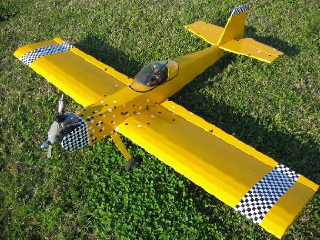

ORIGINAL: nmtr13
John
I have had a 4*60 for 3 years built from a kit and still love it. To answer your question, I use full flaps with 4% up elevator. This prevents the plane from diving on approach and keeps the plane level on approach. My 4*60 has a YS .91FZ spinning an APC 15x6 with a total of 7 servos. Dual (seperate) elevator servos, pull-pull rudder, better tail wheel, counter balance rudder, 1" extra on rudder and elevator. I also have a parachute drop door built into the plane. This is so much fun to drop candy, chocolates, pepperments or a parachute during fly-ins for the kids to catch so the winner will get a prize. The parachute (candy) hatch is fully motorized up and down from a flip of a switch. In normal flight, the plane appears normal until the hatch opens and a parachute falls out or candy rains down over the crowd. This is a true crowd pleasure (literally). LOL...
I hope the plane and setup works out for you.

ORIGINAL: Deadeye
Oh God, Eye Heart Four-Star!!! Have a ball experimenting with flaperon, but you really don't need it. DTB, that 4* of yours kicks some serious butt! A YS? I bet that rocks and rolls all day long! I loved this plane sooo much, that I copied it in coroplast. 1/2 pound weight difference, and only costs $40 per airframe! What a great design!
Thanks a lot Deadeye, You are correct about the flaps. This plane floats a lot as it is. The flaps do help stablize the plane more on final not that it is an unstable aircraft at all. The flaps just puts it on rails for the runway so to speak. The YS .91FZ does pull this plane with amazing performance. I am able to do a knife edge loops easily, flat spins, inverted flat spins, walls, parachutes, waterfalls, blenders, etc... With my 1" addition to the rudder, elevators, counter balance rudder and having my CG about 1/2" pass the recommended position also is a plus, so hovering and torque rolling is not a problem at all. The only downfall is once it flat spins, it will continue on it's own even after you try to stop it, but it is a true FLAT spin so I have to stay high to get it out of the flat spin. Unlimited vertical is a very real fact. Once the plane hops off the ground you can point the nose up and continue until you get dizzy. A buddy who flies with me is a policeman who radared my 4*60 doing 116 mph.
