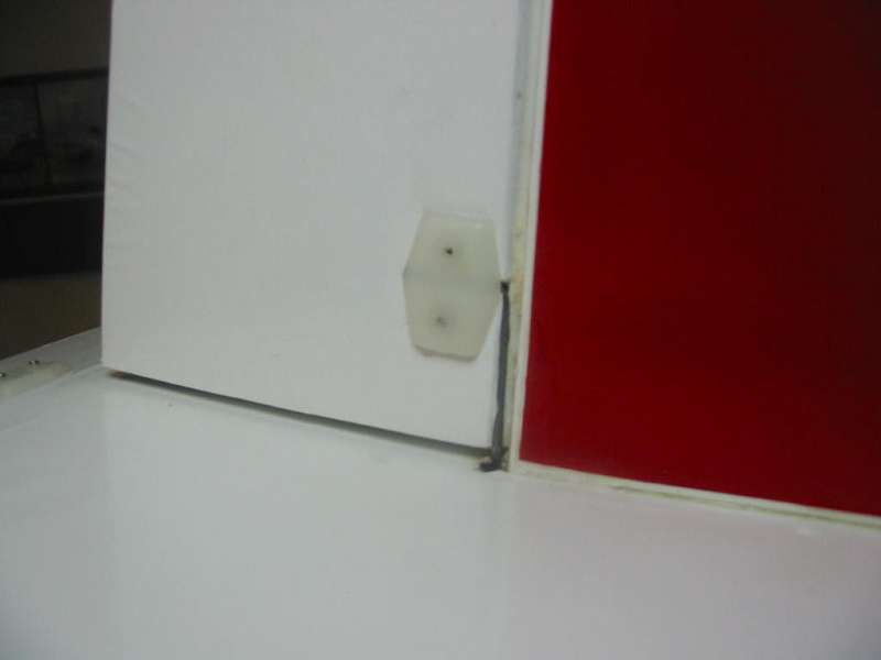

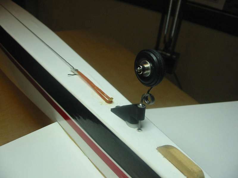

I have had excellent luck with a VERY simple solution. I ran a wire through the fuse and horiz stab, direct to the rudder.
http://www.rcuniverse.com/forum/Conv...2524324/tm.htm
I used a standard steerable tailwheel mount, but made my own wire/spring assy. I drilled down right at the rudder hinge point and ran a wire straight through. This way in addition to the spring for flexibility under load, the wire up through the fuse give it torsional flexibility. The reason I like it is - it looks good and clean, it has no external horns or cables to catch or break and it is just so simple. Once I figured it out it just took me a few minutes.
I can explain a little more in detail if you give me a PM.
