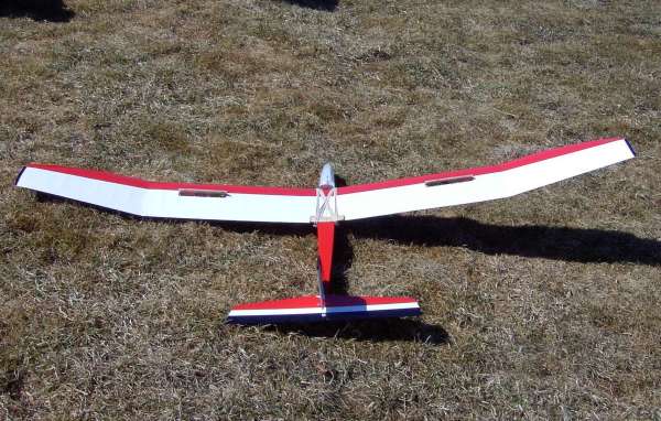

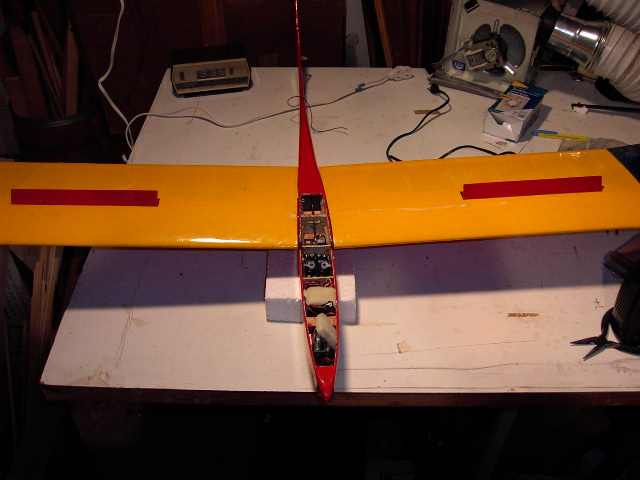

In the photo you will see the spoilers on my RES sailplanes (rudder/elevator/spoilers) which provide glide path control on landing. They are also useful when we get stuck in a big powerful booming thermal that doesn't want to let us out. Pop the spoilers and decrease the lift on the wing.
