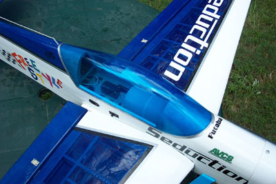

Here is another picture with my seduction Freestyle, much easier to see what I did:

Old 09-03-2002 | 02:45 PM
tmproff's Avatar
Posts: 1,064
From: Humble, TX
Default Receiver on/off switch position
Here is a closeup of that same pic:
