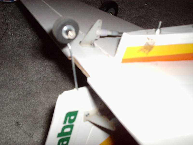

Hi,
I was wondering if anyone has any suggestions to make this thing better?
I wanted to make my Avistar a taildragger so I just jammed a tailwheel up the rudder and cut out part of the elevator. BTW, the labels on the elevator and stab are for my airplane-alliterate dad. I also labeled the wing, ailerons etc. Thanks in advance for your help.

Hi newbie,
try a sulivan tailwheel assambly, mount it to the bottom of the fuse, and run a second pushrod from your rudder servo. my buddy just did this wih his H9 arrow,works great. Sorry no pics. Also, you may want to convert that wing to a bolt on set up while your at it.

I think if you land hard with that thing or the wheel getss tuck somewhere on the airfield, the rudder is gonna get ripped of ... [&:]

Just fit a non-steerable tail wheel. The plane has enough rudder autority to steer on the ground.

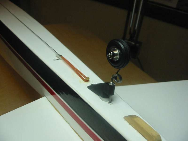

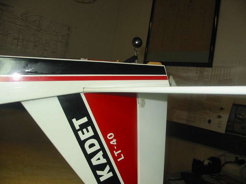

MerlinL14 is right you could probably get by with a non steerable wheel. If you really wanted wheel control, I would mount a tailwheel bracket or even a brass tube off the end of the fuse, and run your tailwheel wire up through the bracket and through a hole in the elevator hinge joint into the leading edge of the rudder. Bend the wire at 90 degrees and secure behind the rudder control horn plate. This will give you much better leverage on the tailwheel and take all the strain off the rudder. I just completed this mod on my Kadet. The only difference is my kadet fuse is a little different but your mod should be even easier.

The above advise on your tailwheel is much better for you rudder's life
