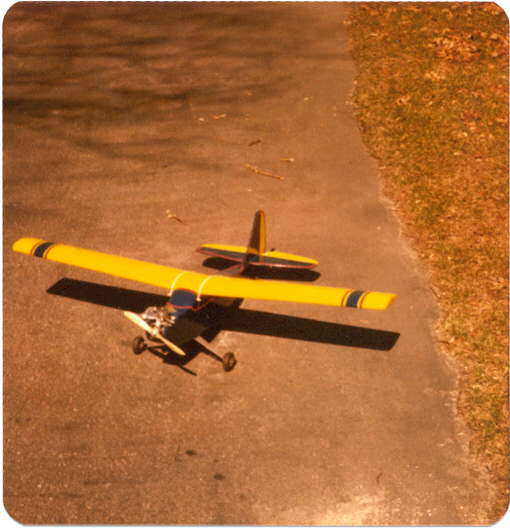

I picked this up off RCGroups about 4 years ago, not as a trainer, but a relaxing plane, slow motion I call it. I don't like these bird cage kits though, a real pain to build.
Takes more patience than I want to put into it, having built an Elder 40 before, similar ladder of match sticks make up the fuselage. It is however much lighter, so that's the benefit. Construction reminds me of Guillow's kits when I was a kid.

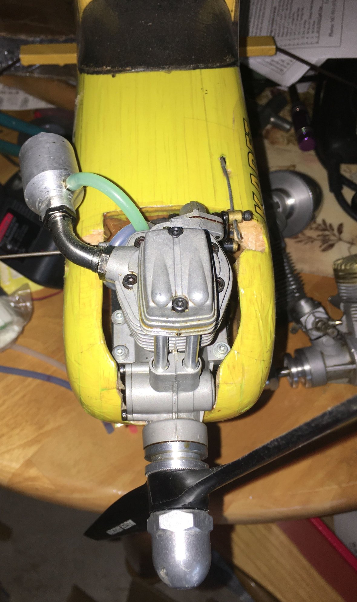

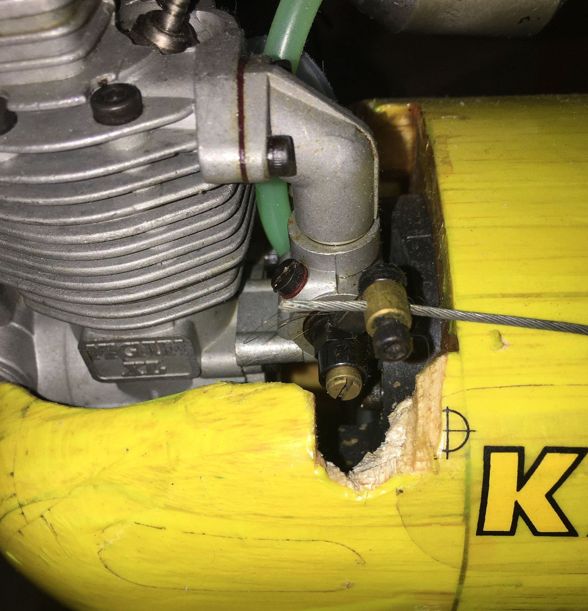

This yellow Seniorita is still in my hangar, I replaced an OS .48 Surpass, with this Magnum XL .52 4 stroke, dropped right in place. Flies great in spite of its aged look. They all look great in the air. The landing gear is held on with 1/4 - 20 nylon bolts. Only thing I want to do is replace those inconvenient dowels with 1/4 - 20 bolts and threaded hardwood mounts to secure the wing without messing with rubber bands. Being glow powered, the combination securing a wing down with #64 rubber bands is just messy.
