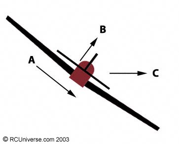

To answer your question ( IE "How do I turn?" )
You are now going to learn to do an Aileron Turn.
(Historical note: THIS, above anything else is what put the Wright Brothers way ahead of their competition)
First, you bank the wings with the ailerons, let's say to the right (don't worry about how much just yet).
As you know, this won't cause the plane to turn, but now (See picture) gravity wants to make the plane slide down and to the right (Arrow A)
Now, (Note: Some planes require that you continue to hold the bank with the ailerons, and some do not) while maintaining the bank, apply UP elevator.
As you know, "UP" is a relative term (In other words, UP means DOWN when you're inverted) So since your wings are banked, "UP" is in the direction of Arrow "B".
The combination of the two forces result int the plane turning in the direction of Arrow "C"
Now, as far as "How Much do you bank?" let me ask you this: How much do you turn the steering wheel of your car to make a turn? It;s impossible to say because all turns are different.
The more you bank, the more up elevator you'll need to keep the nose level. But you MUST remember two things:
1 - To tighten a turn, you must use BOTH controls! By just adding more aileron, you will only roll the plane (As you found out). Once the plane has reached a 90 degree bank, continuing to bank will make "UP" become "DOWN". So the tightest turn you can make would be to roll the plane 90 degrees, and apply full UP elevator.
2 - If you ever get in trouble - LEVEL THE WINGS before you do anything else! All too often a rookie goes for his first "Walk of Shame" because he banked too far (Semi-inverting the plane) and then panicked and pulled "UP" (See note about "UP" meaning "DOWN")

With reference to MinnFlyer's drawing and to be slightly technical. The wing generates an amount of lift ALWAYS perpendicular to the wing surface. This would be shown as arrow B. In level flight all it is doing is holding the plane up. Once you bank (roll) the plane most of the lift continues to support the plane but some of it pulls the plane in the direction of the roll (arrow C). The further you bank the plane the more supporting lift you will lose. Since you have lost a portion of the supporting lift you need to now apply a small (for shallow rolls) amount of elevator to compensate or you will get motion in the direction of arrow A. As you return to level flight you will decrease the elevator input. The amount of elevator input will depend upon a great number of things such as a/c type, wing shape/type, speed, amount of bank and others. This is one of the many things your instructor will help you with. The horizontal stab usually pushes down in flight to keep the plane in balance but that is another subject entirely. There may be some theorists out there that may argue my exactness but I am substantially correct.

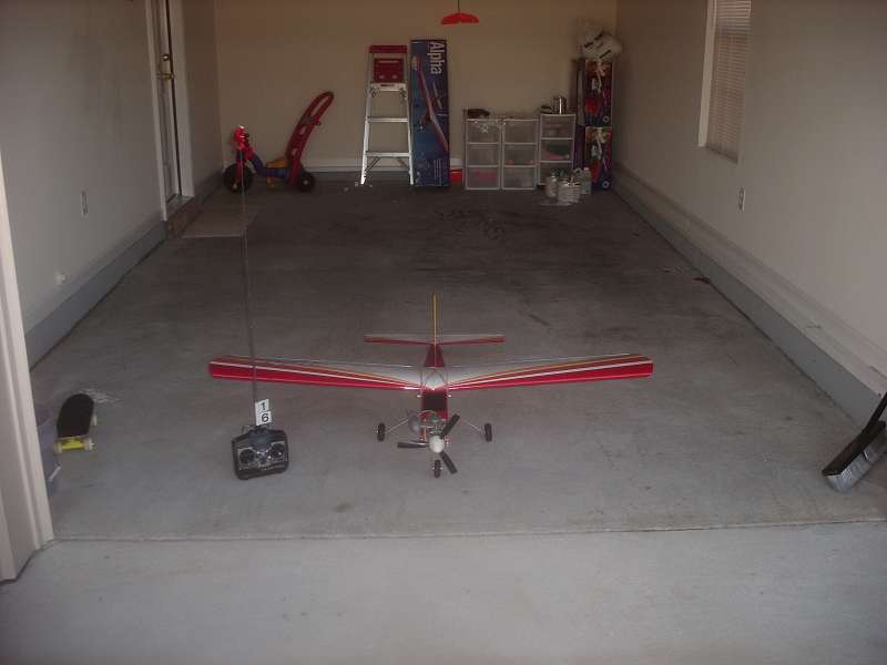

well guys the assembly went pretty well except for a screw in the horizontal tail would not fit into the nut. I went back to the hobby shop and he had a box of nuts, the one that came with it was obstructed with a piece of metal or something. Other than that it went ok. I guess the glow starter is not ready because it would not start its only been charging for 4 hours. I will try in about 5 more! I knew I kept this box for something!!!!!
