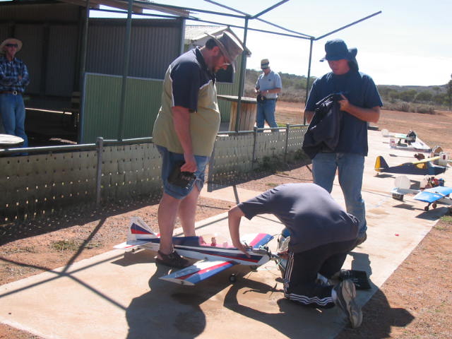

I said that there would be pictures and here they are:
John

Fine looking plane!! I may have to gets me one of these!

Nice plane and a nice field.

I bought it second hand.
The field is a dirt strip, but very few pot holes or large bumps[8D].
The lads at the field have nicknamed it "The Flying Fish" is it's called the Dolphin.
John
