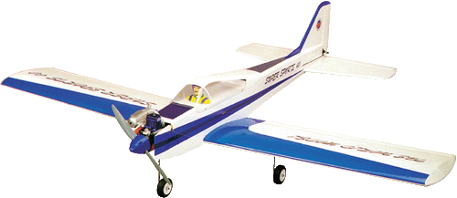

Old 02-07-2005 | 01:00 PM
Posts: 539
From: Commerce Twp, MI
Default RE: HELP!!! Maiden flight right off
This plane flys rock solid.
It is a tri gear, low wing, semi symmetrical with some dihedral.
Here is a pic.
I have had this plane for 3 years and love it.
Great second plane.
