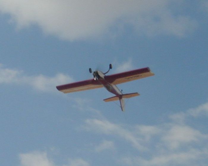

Hello..
I have A SE (it's an ARF) with a Saito 72...and it became my favorite plane from the very first time I had it in the air. You won't be disappointed. It does everything well...lands like a trainer.
http://snow.prohosting.com/mspringf
The picture below shows it inverted...about 10 feet off the ground...it spends a lot of time upside down.
