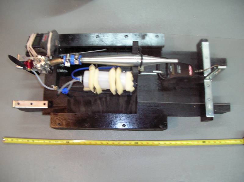

Now if you want to get more complicated this is version 2.0
you can now messure thrust and rpm
If you need any help or more pics/details let me know
(btw if anyone needs i have the planse for that starting stand in the backround of the post above i might be able to scan and post the plans )

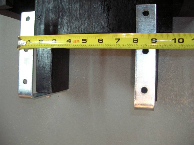

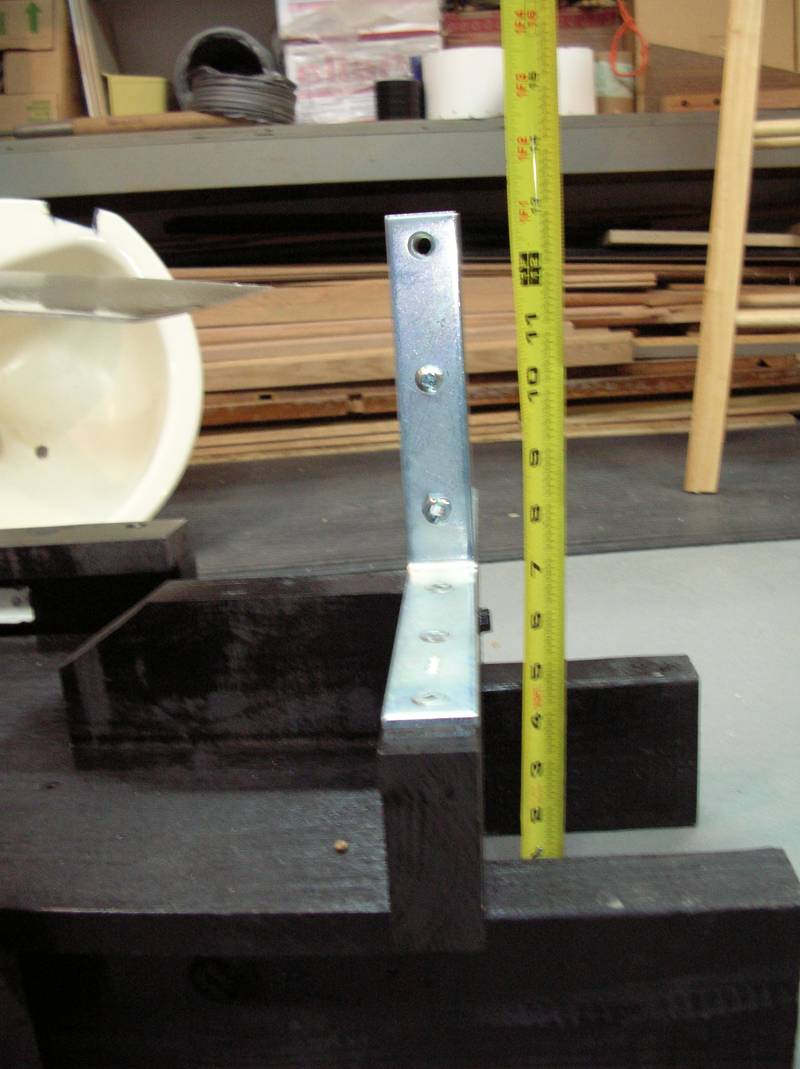

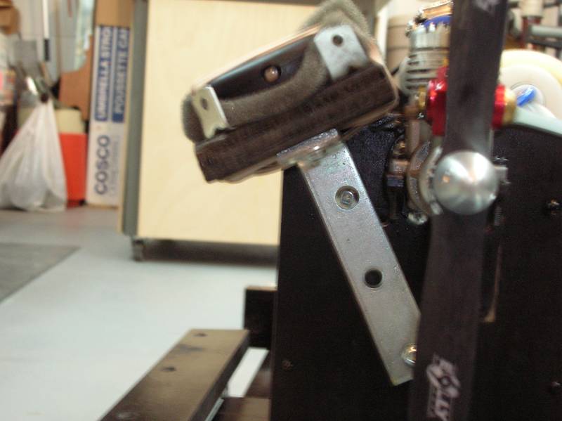

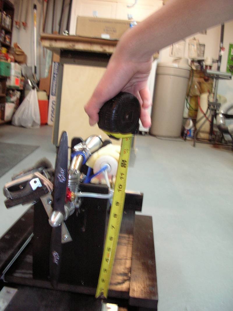

So i hvae gotton multiple Pms / emails from people that would liek closer pictures of the test stand so here they are
If you try and build this I would recomend you try and find sliders with the least amount of fritcion and get a scale that is as preciseis as possbile, and maybe evan try and lighten up the structure that is on the platform.
You may have to re-enforce the botom depending on what kind of wood you use
