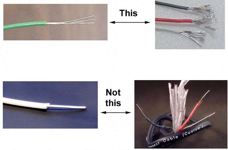

Old 02-22-2005 | 08:48 AM
MinnFlyer's Avatar
Posts: 28,519
Received 9 Likes on 9 Posts
From: Willmar, MN
Default RE: Lengthen the Y harness
Any wire will work, but make sure it's STRANDED (As opposed to solid core)

Joined: Aug 2004
Posts: 227
From: , THAILAND
Thanks everybody for their kind effort in explaning to me. The illustration on wires really help me alot. Thanks Minnflyer. I'll get an expert to do the soldering.
