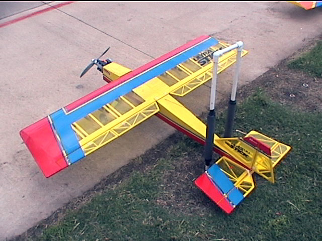

If you have the opportunity to put something in that is permanent, here is a picture of what we use at our club. For most planes, we have a stooge set up where two lengths of pvc are set in the ground. Then a U shaped piece of pvc with water line insulation glued on to protect the finish of the plane's tailfeathers is inserted inside the two pvc pipes in the ground. Once the plane is started, the stooge is removed and you are on your way. For larger planes, we have a "D" ring mounted in cement and then a web strap is placed around the tail to hold the plane in place. Here is a picture of the PVC method:
