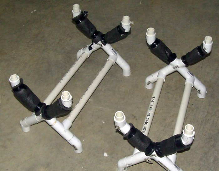

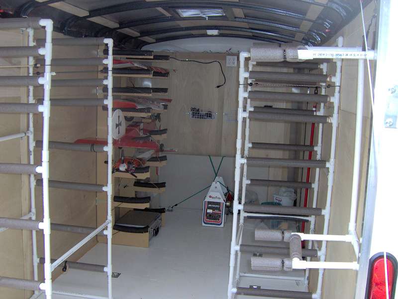

My brother and I just recently bought 6 X 12 enclosed trailers to store/haul our planes around in. Currently we have two PVC racks that can hold a total of 8 planes each, with plans to build one more so that we could haul up to 12 planes per trailer. My brother has added a battery, and electricity to his trailer, so that when he gets home, he just plugs the cord in, and his planes charge (using an automatic timer). Or, at least, that's the plan when all is finished. I too will do this to mine. Here is my question:

Right now I have PVC racks in mine, and they work well, and are very light--easy to take out when necessary. However, I can't front load the planes, I have to feed them through the rack, and that becomes a PITA when you are trying to fish a plane out from in between two others. I'm fixing to build some racks out of painted MDF board that will allow me to front load everything. They will be mounted to the trailer on hinges, with a deadbolt on the bottom that will lock the racks open--for hauling planes. When necessary, I'll remove my planes, close the racks on their hinges, and deadbolt them shut against the wall. It's all in my head right now, but in two weeks it will be in my trailer, and I'll have pics then.

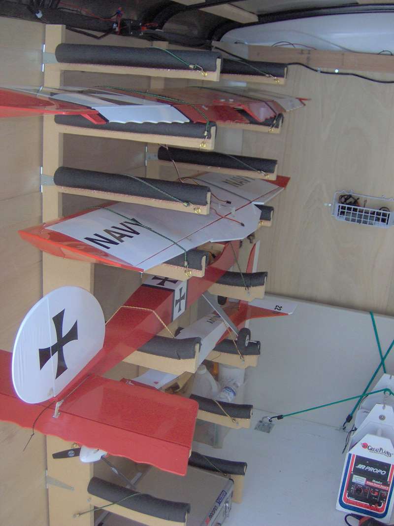

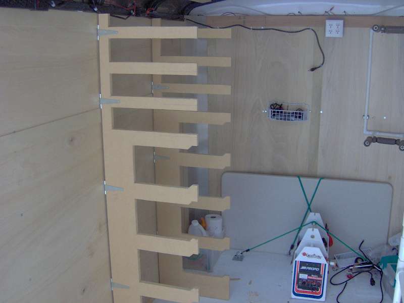

Here are a couple of pictures of the rack I built today. Just built one today, will build one more next week. You can also see the PVC racks I have been using, but they are a PITA. I need to paint it, but I Think it turned out pretty well. They hinge to the wall so that I can get them out of the way if I need to use the trailer for something else!

2Slow,
Love the trailer! Great setup!
Allows for trailer flexability rather than dedicated use. Just what I was looking for.
Looks like a good size trailer! How big?
The wood holders, plywood or particleboard?
My eyes are not what they used to be but am I seeing sliding pin style door latches to secure the arms in use and when stored back?
How are you tying these arms to the wall of the trailer? Through the wall material or the trailer frame itself? Wall thickness if the wall?
Any tips or "if I did it again, I would have" that you might suggest to someone that may want to copy your effort?
It's probably one of the best looking Professional looking trailers I have seen!
Great job!
Where is the hot tub?

mmalone,
The trailer is a haulmark 6 X 12, and it's just the right size for me. I made the racks out of MDF board, which is similar to particle board, but much stronger, and much denser. It can be picked up for about 20 bucks per 4 x 8 sheet, and is often used in making furniture that is going to be painted, so I figured it'd be strong enough for what i need. The racks are attached to the trailer wall frame by way of 4 inch strap hinges. The deadbolt locks on the bottom go into holes that I drilled out to size. I tried to place the locks high enough that they would go about 1/2 inch into the floor, but no more so I didn't have to drill all the way through the floor. The rack will accommodate pretty much any 40 - 60 sized plane. On my next one I'll have a rounded fuse slot to accept my Texan once I get it built.
Actually, I'm fixing to build two more for the trailer and I think I'll do them exactly the same way, so I don't guess I'd do anything different. That rack is actually full with planes I currently fly, and I have two more waiting to be built, so I'll need another rack soon. I'll just go ahead and build two more. The nice thing is that they're not in the way until I need them!
As I said before, I'll also be painting these racks next week. I'll get some final pics next week or so.

make sure you seal that MDF....once it gets a little wet, it turns into a wick and will actually draw moisure from the air and start to fall apart
