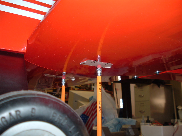

Here is my cheap balancer... it works. You could try a servo extension on the battery if you really need to move it (if you do, make sure you use about an inch of electrical tape to keep the connector from coming apart accidentally) , but 4 or 5 oz. of weight won't make that much difference. It just sounds like a lot.

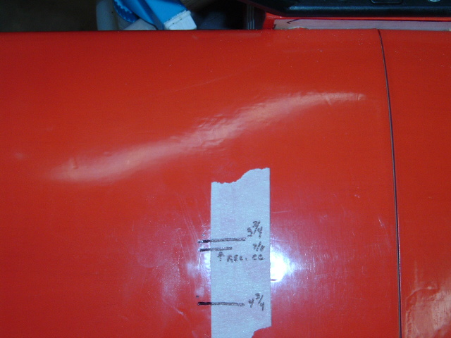

I've been flying for over 40 years, and I still use my fingertips for balancing. It's as accurate as you need it to be. IMHO using a fancy mechanism for balancing is about as needed as buying a plastic "Rubber Band Puller" so you don't have to use your fingers.

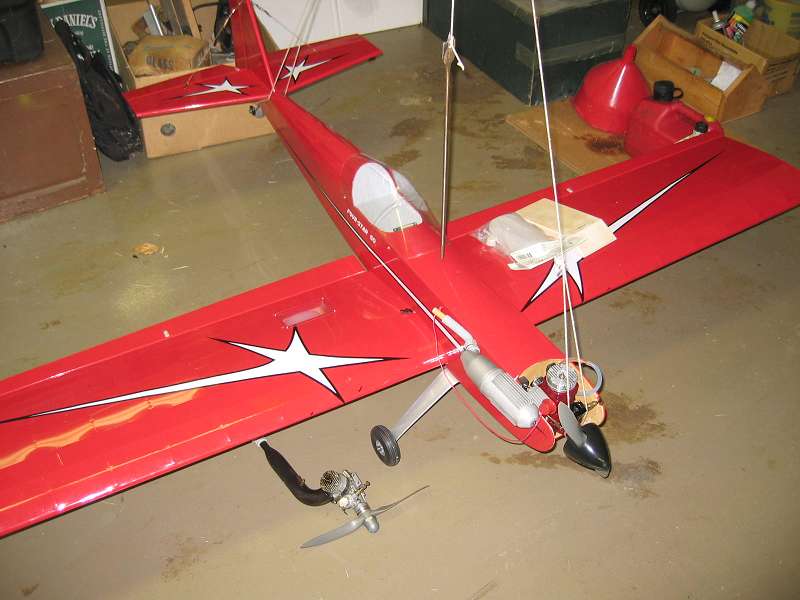

My experience is that the following method works well and it is easier to move stuff around to balance the airplane.
You might try hanging the airplane from above with a mason twine cradle from engine to tail. Then drop a plumb bob from the suspension point. When the plumb bob stops swinging it will point to the balance point. The airplane should be approximately level or at flight attitude.
I lay the battery (or weight) at various locations on top of the airplane to find the best balance location. There is nothing to buy or make and the wheels can be a few inches off the floor or table just in case something slips. The point of attachment of the cradle to the airplane is not critical.

bills,
I'd like to see a picture of what you're talking about. It sounds interesting. Next time you balance a plane, would you post some pics of that setup?

I got this one, I just threw up my combat plane for the pic and the plumb bob string is short but you can get the idea. Just hang the plane and the plumb bob from the same point and the plumb will point right to the place the CG is at, Just put a mark on the wing where the CG is wanted and add till the plumb bob points the mark on the wing.
Dauntae
Dauntae

Minnflyer, jaka, try this,
Balance a plane on your fingertips as in the normal way. Once it's settled, bend your fingers forward. Notice how much the plane moves in accordance with your fingers??
The 'gadget' I described is almost the same as Bingofields, just split in half, and I'm sure no1 here will say thats terribly hi-tech. For that few pence/cents(not even pounds/dollars), you get a lot of extra assurance, and confidence in your plane.
On no less than 3 occasions have I fingerbalanced a plane only to find that its at least 3/4inch out.
Human error is often the biggest form, just like golf, the more we can remove it, the more consistent we'll be.

Now try this...
FLY the plane. THAT will tell you where you want your CG to be.
Many people seem to think that the CG is this magical place where the plane MUST balance. True, there is an AREA where it will fly best, and a few areas where it will not fly at all, but anyone who thinks that if they balance their plane exactly where the manufacturer suggests it will be perfect is, well to be honest, a rookie.
The initial balance point should be withing the manufacturers suggested range (BTW, note the words SUGGESTED and RANGE). So to get it in this ballpark area, a ballpark method is all that's needed. Now, FLY the plane and determine if you want to change the CG.
If a MFG says "Set the CG at 4 1/2" behind the LE" they don't mean that that's the best place for it. they mean that's a place where it will fly without being too nose or tail heavy.
But if you balance it exactly at 4 1/2" that doesn't mean it's in a good place - nor does it mean you'll like the way the plane flies with the CG there. It is just a reference point that should probably be changed once the plane it flown.
So why get anal over getting it perfect?

Yes, this is pretty simple, a piece of 2x8, and 2 pencils with good erasers. It puts the plane up where I can add or subtract weight and see the balance effected. That's all. Works whether you are balancing right side up, or upside down. Like Minn said, the recommended cg is the starting point.

All aircraft with a constant cord wing have their CG at around 25%-30% of the wing cord...
where is it on your airplane? As Minnflyer said .The recommended CG location is just a starting point.

Old 03-02-2005 | 11:51 AM
Joined: Sep 2004
Posts: 3,312
From: Greensboro, NC
Default RE: How to balance this thing?
2slow2matter,
Here are pictures of a trial balance of a three-engine project under construction. The battery is not in the airplane and the balance is to the rear. The right tanks are mounted in the wing and the left tank and cover is on top of the wing. The engine boxes are not far enough along to allow trial fitting the engines.
I like the cradle method since it allows trial fitting parts. The wheels are not on the floor and the oil bottle is to prevent rotation.
I prefer to pay attention to detail. Enough things will go wrong without my help. A lot of people are very casual about balance and control throws and the approach works for a while. A US Air commuter crashed on take off and killed about 80 people a few years ago. The loading created a rearward CG that was thought to be within tolerance.
Bill S

BillS,
Would incidence or angle change anything when you are checking cg in that rig? IE>> nose up or down attitude have any effect on where the plumb would be ? Thanks..

Old 03-02-2005 | 05:04 PM
Joined: Sep 2004
Posts: 3,312
BillS,
Bingo field,
The attitude (of the airplane) makes only a miniscule difference in the plumb bob location but I prefer to have the horizontal stabilizer level. If one wanted more accuracy an incidence meter could be put on the stabilizer but eyeball is probably more than good enough.
Bill
Old 03-02-2005 | 08:17 PM
bingo field's Avatar
Joined: May 2004
Posts: 1,732
From: Mt. Morris, NY
I didn't figure it made a major difference, but you know what they say when you "ASSUME". Since the plane is suspended more like a pendulem, the weight will go under the bob, and the center of gravity is exposed rather than the bob goes to the center of gravity. I have to put these things into perspective before I can understand them..... With the pencil stand, once the cg is marked, it would show tail or nose heavy, and you add weight like on an old scale until it balances closely to where you want it. Nothing fancy, just gets you to where you know where it balances out at.... Thank you for the explaination.
