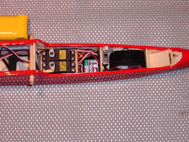

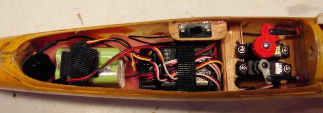

Don't knwo what kind of plane you have. Here are three sailplane receiver battery installations.
ID:	239261   Click image for larger version
ID:	239262   Click image for larger version
