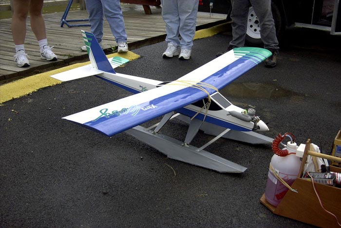

here are some pics..
I'm wanting to just be able to take off fly and land, no areobatics...
(kind of a grudge match against this lake)
last time when attemting to fly of water I flipped it before takeoff it nosed over straight into the water (prob. because of the toe in wich if I rem correctly I did on the advice of another)..
The servos got some water in them and once I finally did take of the thing went nuts and full powered into the water, this is what took me out of flying...
I haven't "preped" the plane any (sealed the electronics, sho goed the wing saddle or anything) what should I do?
Also I don't even know if on my arf if the firewall is fuel proofed..??

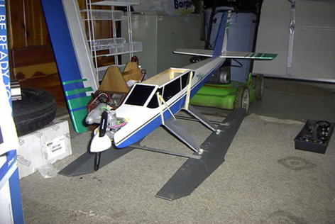

in the previous picture those are the only two bolts going through the floats, not really there to "hold" them on but kinda align them better and keep them aligned...
here is a side show,
comment/advise away...

Without being there it's hard to know if the attachment is adequate. Large washers under the screws might help.
Having just recently begun flying off floats I can say it is quite easy but even if it's calm and things are done right the floats still take some beating. Water does provide some resistance even if you just touch it initally on landing. I was surprised though at how relaxing it can be when you have a LARGE runway and no trees to avoid on final.
The step, up to 1 inch behind the CG, is OK but the 1/4 inch mentioned is probably ideal. I know I stirred up a little water on my initial run ups and having the step more forward would have eliminated some of it.
You still have to keep the CG in the right region relative to leading edge of the wing, so that has to be checked. It changed- you put floats on.

Jeremy, John is right on with the CG and Step. You're mounting looks like it might work. Like 4*60 said, it's hard to tell without being there. If your there on Saturday we can take a look or Pat or any of the guys can help you out.

Jeremy, I may have misphrased a bit. All I meant was your goal should be to have the CG in the same place as it is when flown on wheels after you have installed the floats and the step needs to be that 1/4 inch behind the CG. Many installations require lead forward when floats are installed and for a quick one time outing you can just hammer some lead flat and glue it to the bows of the floats on top.
Your installation I know is what aircore uses but the airplane does not appear to be an aircore and the front rubbers look as though they angle in. What can happen here is the struts if they are not keyed in some way side load on landing which can and will happen will slide the front one sideways and cause those angled in rubbers to pop off and the result will be another wet airplane. If you use the rubber bands do key the struts so they are not free to slide sideways or fore and aft.
Another easy way to do it that is not difficult and much better is to simply cut some eighth inch ply about and inch wide and the length of the inside of the fuse to just snugg up aginst the sides. Epoxy that thing in there to the bottom and just epoxy some tristock from that to the fuse sides then just bolt those struts on with bolts and blind nuts and use a big old washer made of wood or smething where the bolt goes through the corroplast. This is important for another reason and that is there is another important factor that you have not mentioned. It is neccessary to have the wing incidence in relationship to the top deck of the floats about +2 to +4 degrees. In other words the bottom of the wing should not be parallel to the top deck of the floats, the leading edge should up a little compared to the top deck. When the airplane is floating in the hot tub or the kids wadding pool the tail should be slightly low. Now for the best part of bolting those struts on if you use long bolts and do not cut them you can very easily adjust this angle even at the lake if need be buy cutting some thin ply spacers that you install between the fuse and the struts front or rear what ever the case may be. I always carry stacks of these spacers for my airplanes when I attend a float fly.
