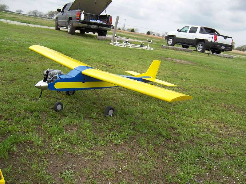

Here's mine. It's almost the same length as the bed of my truck. The frame being longer than the wing means there's little chance of damage if it does slide slightly forward or back. It's stiff enogh to lean against the garage wall for storage and battery charging.

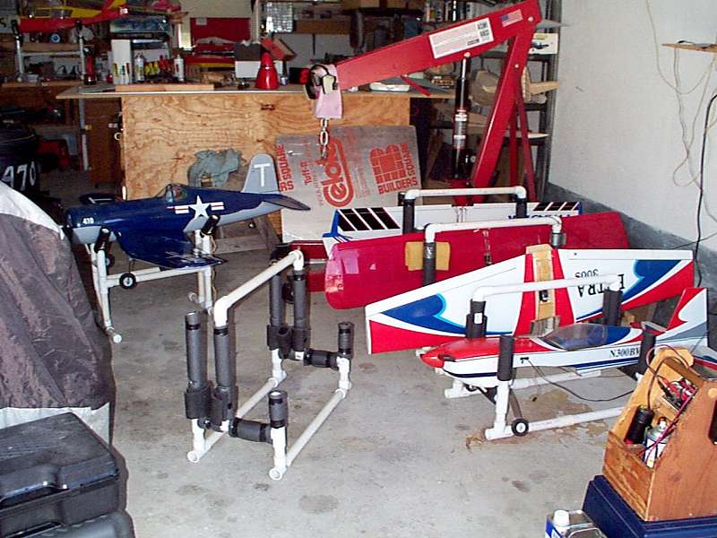

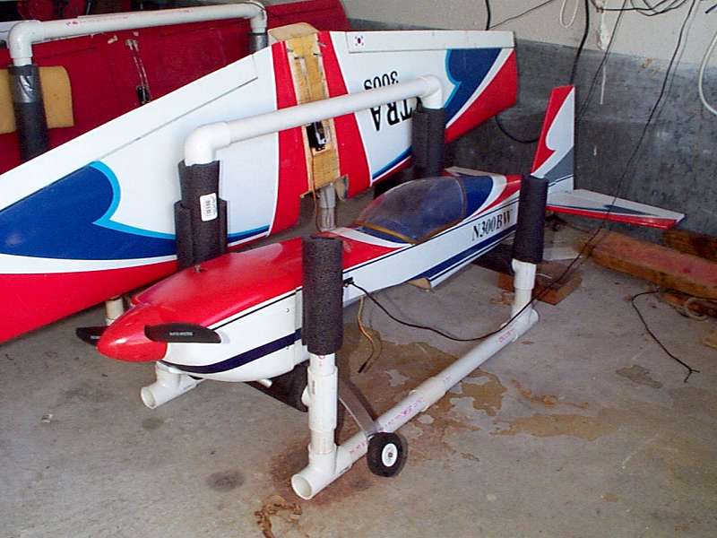

Here's a couple of pics of my carrier......
Sorry, couldn't resist...

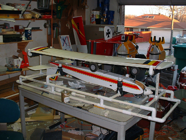

Heres what I do for my 60 sized planes. Not too practical for giant scale though.
Edwin

My brother designed and built the carrier for me. I don't have exact dimensions. I'll measure it this weekend and try to get a few more photos. The bottom frame is just under 6.5 feet by about 2 feet. The uprights for the wings are even with the top of the bed sides of a 2000 Silverado. I have a fiberglass bed lid so it doesn't get blown around at all. It's all 3/4" pvc for stiffness. I drag it about halfway out and lower the end to the ground. Then I drag it wherever it needs to go by the other end. I never need to move it more than 20-30 feet so I never felt wheels were necessary; and the frame itself makes a good handle. The wings have a bungee across both ends so they will not slide off if I have to stop quickly. The fuselge is also secured with little bungees. I can grab the frame on either side, near the center, and carry it like a suitcase if I need to. This is the only other photo I have. The PT-60 is my current trainer. The carrier is in the background near my truck.
