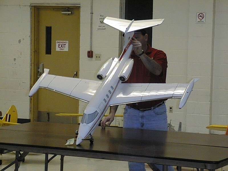

HERES ONE OF MY 3 GP LEARJETS I BUILT

Heres both my Lears at a static show....Won third place for the "Rainbow Lear....
