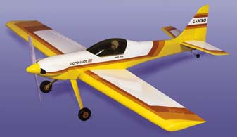

heres a pic of the acro wot for you[img]

Nice plane. Who kits it? Or are there plans available?
nevermind, I found it. 40-60 size at that.
http://www.chrisfoss.co.uk/Default.htm
No price info though.

hi the price in the uk is arround £80 to £100 im not sure if its available in the states but most probably not as our prices here compaired to youres are so expensive!!.im sure there will be plans available from somewhere though as a lot of his planes are not artf but full build.though this one is artf i bet there are plans for it somewhere.if i find any ill post a link on here for you!!.
