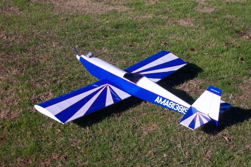

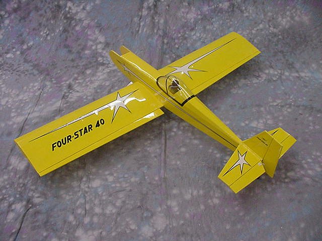

I had the OS 40LA in mine and it was way underpowered. A 46AX or 50SX would be perfect, or the TT 46 that Rubberduck recommended.

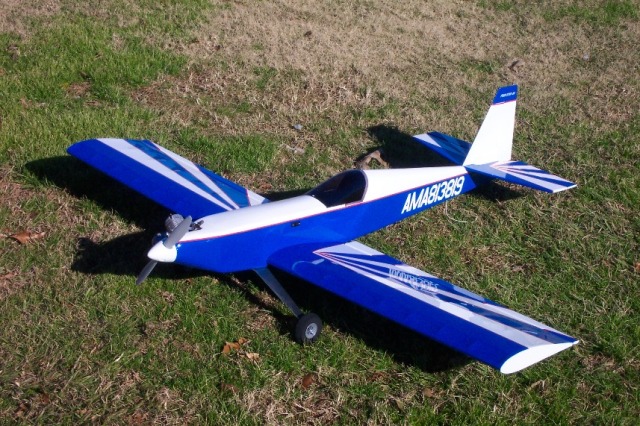

I just bought a Four Star 40 that has been pre built from the kit and I am planning on running a O.S. 46 FX that I just bought here on RCU. It's now on my Avistar, and man that motor really rocks. I am still in the process of breaking it in have only run a few tanks thru it. Do you guys recommend sticking on a 10X6 prop, or something bigger? I can't wait to throw in the radio gear and motor in fly this bird. What I have read, it is sweat flying airplane.

newb and Matt, with the 46AX and the tall landing gear, I would go with either a 12x4 or 11x5. I currently use an 11x5 on my SSE with a 46LA, and it's the best I can get with the engine I have. With the 46LA, you will much better performance. Also remember that you control the speed with the throttle, so find a prop that works best for the type of flying you want to do, and then just cut back the throttle when landing or just flying around.
