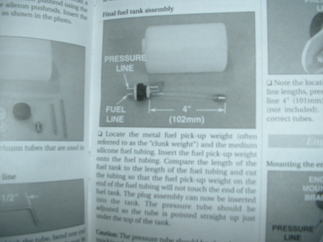

The fuel clunk attches to the metal or platic tube inserted through the rubber seal in the front. Pressure nipple beside You want to make sure that pick up line inside the tank is clear of he rear of the tank. Close but not touching. Hold the plane or the tank depending on where you are and see that the clunk moves freely form top to bottom, side to side without biding on the back of the tank. Each day before I fly I flip my planes around to listen for a free moving clunk.
Here is a pic of my Avistar instructions. They explain better. This is typical for all planes....several optional ways of doing these lines are in use. This is basic.
By the way the "Caution" you cant read say's not to bend the pressure tube up so much it touches the tank or fuel flow might be interrupted...do not overtighten the stopper plates or damage to the tanks might occur.
