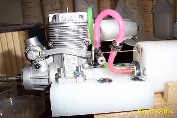

Hi' to everyone:
I have never broke in an engine before.
I built the test stand, does everything look
alright to you folks ?Can I break the engine
in without the nose cone or prop? can I start
and run it with just the nut on ?
The engine is an OS 46 AX .

The only thing I see with you test stand is that the tank may be low. You may want to raise it up.
As far as running the motor without propor spinner. That is a huge NO GO. You can get by without the spinner, but you have to have a prop on it. The motor is designed to have a load on it and running without the prop will wind up damaging the motor.
As Geistware said, it would probably be easier to just run the motor on the plane.
hope this helps.

Ohhhh " why is there engine test stand's on the market for sale ?
Is this just another way to extract money from us , when
all we have to do is bolt the engine to the plane and run it lean ,
for awhile.
Yep' I feel like an idiot if that's the case.

I'm sorry if I implied that to you, because that's not what I meant. When you have the plane ready to go it's sometimes easier to break in the motor on the plane. Doing it this way also let's you test your fuel system before flying. It will also give your plane a good "shaking" so that you can make sure all the bolts, nuts, and connections are tight.
But there is nothing wrong with a test stand either. I use test stands to break in a motor when the plane isn't ready yet. So you didn't waste you money at all.

What problem's do you expect I will have starting an OS inverted engine ?

Hey Radcom, You have purchased a quality engine that can last a long time. Why not just go by the book and break it in on the stand for a few tanks and then fly it rich for the rest of the gallon. If you did not get the manual you can find it on the OS/Tower web sight or right here on RCU with a little searching. Some flyers just start them and fly them and do fine but I just prefer to do the bench break in. You could probably read all night about the different advice on engine break in but I think you really need a little help from someone with a little experience. Once you learn to start and tune your first engine you will see that there is no magic involved but just a little common sense. Safety first around the spinning prop.

1. Getting the fuel tank properly set for the carb. The tank needs to be lined up with the center (spray bar ) of the carb. An inverted engine almost always has the fuel tank too high.
2. I STRONGLY suggest a remote glow starter. I get "very nervous" sticking my hand under a running engine to remove the glow starter.
3. With the engine inverted, the glo plug tends to get (and stay ) wetter than with the engine upright or sideways. You will probably need to use the power panel for the glow ignitor. You can crank the voltage up to around 3 volts if needed to keep the plug hot, where the "hot shots" are only 1.2 volts.

No. Don't run the engine on the field stand. It will in no way support the engine at full throttle.
Secure the plane using some sort of a tie-down that holds the plane in place on the ground or use a flight bench that has uprights that go in front of the wings. Then use something in the rear to hold the back end down (bungy cords loosly wrapped around but tight enough to hold the aircraft down...will work). As someone said, run it rich not lean, at full throttle for about 20 to 30 seconds then throttle down for about 10 seconds then back up at full and rich.. continue the cycle until you have burned about three tanks of fuel.
Flying it without breaking it in chances a dead stick at an inopportune time so its best to do it on the ground.

Actually most of the guys with the inverted engines start them with the plane inverted and then carefully turn the plane right side up. 4 strokes aren't bothered as much by inverted running. If I had a plane that needed an inverted engine I would look at one of those. Meantime I just stick to planes that have upright or sideways mounting. I agree with breaking in the engine on the plane. The break in period may help you catch other problems with the plane if there any. I was assisting a new guy to break in his engine when we lost control of the throttle. I pinched the fuel line to kill the engine so we could check the problem. The servo tray wasn't glued in properly and it had vibrated loose! Nice to find the problem before the plane took off.
