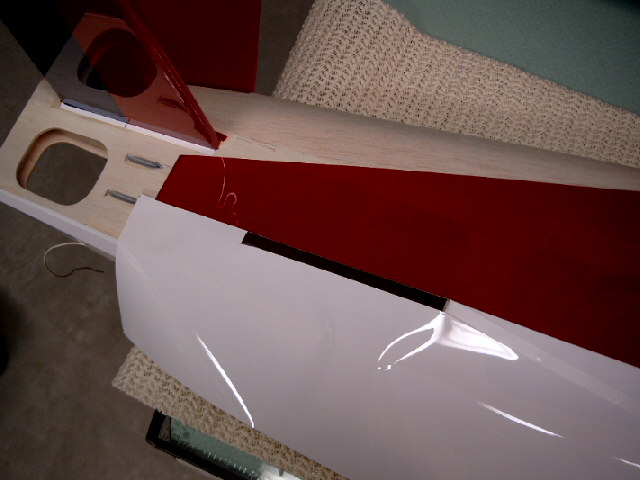

Well, I cooled off a little bit from my frustration.
I'll say, the wing came out decent. Could be better, but not bad. The problem is the fuse. around the elevator and rudder. Geeze, its a pain in the BUTT!!!
I do have one question though. On the fuse, it was red - white - red.. Well, its one piece of red, one piece of white, on piece of red. Why do this rather than just laying red down all the way around and then white accent strips??

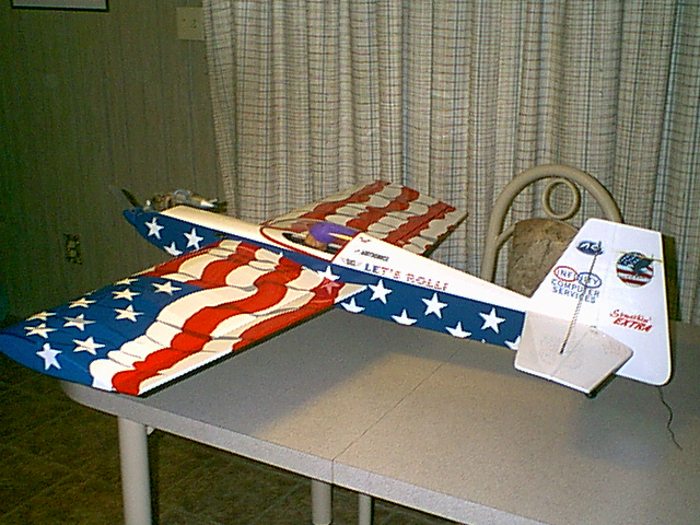

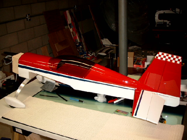

Just some of a Cap I covered for a friend. All seperate pieces including the strips in black.

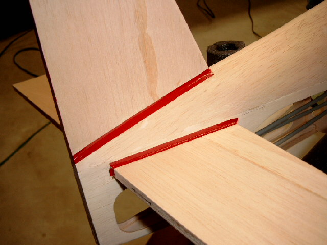

I cut one piece of covering big enough to go over the entire side plus a little extra. I htne tacked it down around the edge of the fuse. Once I had it all tacked down and I then went back and carefully ironed it down the rest of the way. Once that was done I trimmed it so the I had an overlap of 1/4 inch or so on both the top and bottom. I then iron down this overlap.
Now cut a piece for both the top and bottom and iron them on. Once everything is iron on good then seal the edges with clear nail polish, or trim solvent, then grab the heat gun and shrink out the wrinkles.
As I mentioned, this is how I did my SiG Something Extras and it worked well but others may have better ideas

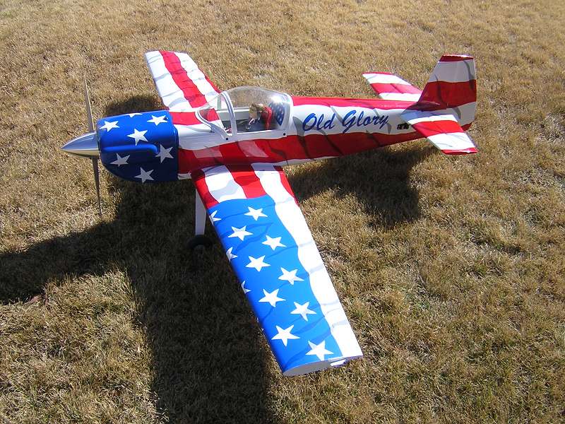

Liberator,
I made the flag. RCU member Termagator posted a how-to on doing a 3D flag. It's really fairly easy to do. You can find the thread at
[link]http://www.rcuniverse.com/forum/m_603331/anchors_603331/mpage_1/key_flag/anchor/tm.htm#603331[/link]

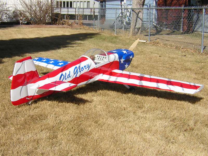

bobbykokinos,
I guess I'm the oddball on here, but I prefer to cover my tail feathers after they've been put on the plane. They're fairly easy to cover. Cut a strip of covering about 1/2" wide to seal into the joint between the surfaces. Crease it down the middle, then remove the plastic backing and seal it down in the joint between your 2 surfaces. Now when you cover the surface you but the monokote right up to your joint and seal it down. Another way to get stripes is to cover one piece of your main covering and place your stripes using the "windex method" for applying monokote. If you will look at the 3D thread I posted above it explains how to apply monokote with windex.
Hope this helps.

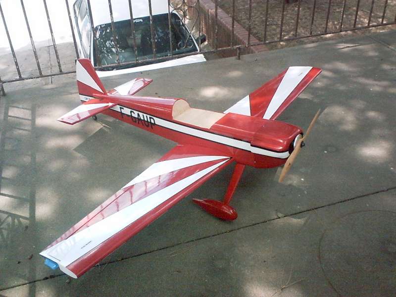

And the final result. I joined the two piecies together on glass before covering. I will be willing to answer any questions that you have about pics. Good Luck!
