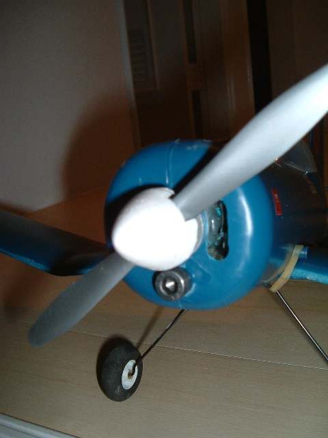

Joined: Oct 2003
Posts: 1,942
From: Taipei, TAIWAN
grounded - i only ran it with the stock motor and 11.1V lipo, 20A generic ESC and it was fine. there were two things i did to it to make it run okay... first was to put a huge bolt on the front of the plane to get the CG right and the second was to ensure that the wing was always seated correctly because the incidence of the wing makes it prone to stalling if not seated correctly.
i think you've seen this picture already but here it goes...
glad you got the engine running! becareful not to flood the engine. if it's very hard to turn over by hand, you've likely flooded the engine... if you try to crank the engine with the starter when it's flooded, you could bend the con rod.
