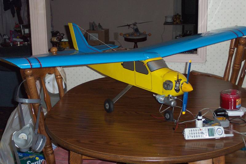

Default RE: Which 4-stroke to decide on?
I have one of these models. I think the Saito .56 would be a pefect match for it. I actually mounted a Saito .72 on mine once (to break in the engine) and it balanced out quite well. It currently has a Supertigre .40 , and that engine pulls it around just fine. It's a nice plane to fly and has good flight characteristics. I think you will enjoy it.
ID:	318121   Click image for larger version
