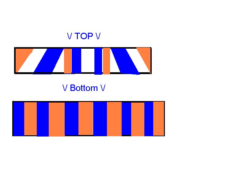

Now for covering options... I want to cover the wing as the picture shows. Will that be good for me to see orientation?

I think that you're going to find that covering scheme very difficult to use right now. When it comes to determining top from bottom you need to have something that can immediately indicate to your brain which is which. Normally this is accomplished by either contrasting colors or different geometric shapes. Unfortunately what you posted doesn't really do either. Looking at them there just isn't anything to set them apart from each other. As you gain more experience you start to learn to "keep track" in the back of your head. For example, when you roll your brain/instinct "knows" that the plane is upside down. You keep a mental track of how your plane is oriented. But even then you still will have times that you lose orientation. When that happens you usually don't have more than a second or two to determine how your plane is oriented, and that's where you need something you brain can key on to figure it out. As you gain more experience it usually takes less and less for you be able to do this. If I can make a recommendation, I'd say do the top of the wing one color and the bottom another color.

ok. I will do that. That will also save me from buying another peice of monokote.

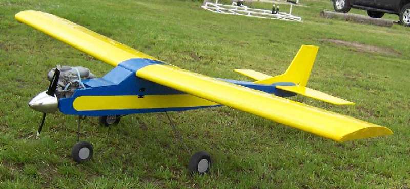

If you use one of your stripe patterns on top and the solid dark color on bottom it would look good and seeing the orientation would be easy. My trainer has a dark blue wing bottom and the top is bright yellow. The contrast really helps. I wrapped the yellow over the leading edge to give me something that stands out for landing approaches.

ok i think i will do orange top blue bottom. I worked on it for an hour tonight while talking on the phone so i didn't get much done, but i did get the gear back on, and i fired up the engine for the first time and can now taxi it, I wanted to so bad tonight, but it was 12:30 and i don't think the neighbors would have been happy. I started it up real quick and shut it off though.

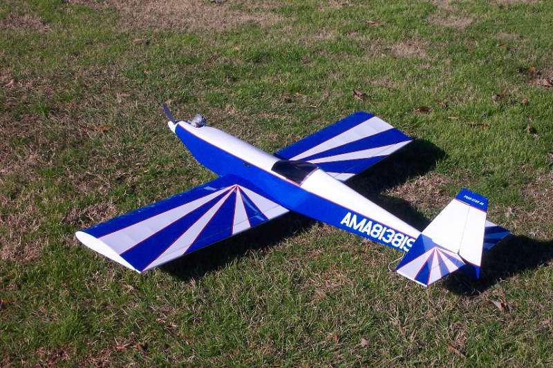

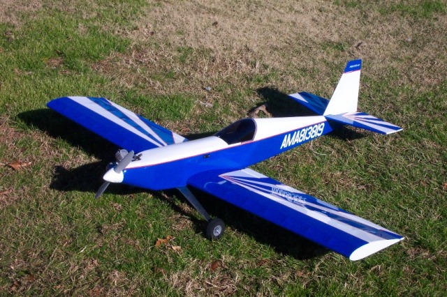

I would definately go with the shorter wing as most others have suggested. I did it on mine and it flew great. As far as the covering goes, see below on how I did mine. The bottom of the plane was solid blue with a large white star on either wing. With the sun burst pattern on the top of the plane, it was VERY easy to see which side was the top and which direction it was going.
