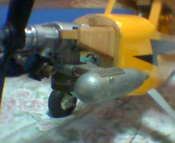

Hi..Iv have started having my own piper j-3 plane setup few weeks back.all the linkages has been assembled.But i have problm actually trying to start my engine.How do you start a gas engine on a plane.Im using a .25 2stroke irvine engine and it is fixed inverted at the front of the plabe.
the carb is facing down.when the fuel goes into the carb it will spill out.so how do you get the engine running?how do i turn the propeller and get the engine running?? many thanks.

hey thanks! but how do i stop the fuel from coming out from the carb? my engine placement is inverted?

my inverted engine irvine.25

When you spin the prop and keep open throttle there will pass fuel into the cylinder.
If in doubt, put the plane inverted on a plane stand and start the engine with the carb pointing up
You can also remove the glow plug and pour (very little) fuel directly in the cylinder.
Just be careful, there's something called hydrolock. This is when you have to much fuel in the cylinde and the piston can't move freely.
If you then force the piston you can break the engine.
It should be tight, but if it's almost impossible you have to much fuel in the cylinder end need to empty it. Remove glow plug and spin prop to vent out the extra fuel.

as for the spilling out of fuel. this is likely because the level of your carb is significantly lower than the level of your tank. so what is happening is gravity is pulling out the fuel once you've primed it to start your engine. you've got to lower your tank so that the middle of the tank is about the level of the carb, otherwise you will always be flooding the carb. this is why having your engine side mounted is always safer than inverted.

Piperofna beat me to it...lower your fuel tank. If you've flown before and this is your first glow engine plane I partly agree. You should get someone to go over some tuning techniques and saftey procedures but I seriously doubt if you'll crash in 30 seconds, everyone is different, some people need more help but like I said if you've flown before then you should be fine with a cub, except taking off will be scarey (keep everyone away and get some help with this-tail draggers are not stable on take off if you don't know what you are doing) but I would have an experienced flier or instructor there the first time at least. As for the ailerons they should be level. Slightly down will increase lift and slightly up will loose some lift but make them level on all flight surfaces. This does not mean you won't have to add some trim into the control surfaces though.

NEVER try to start a glow engine upside down, the chance of a hydralic lock bending or breaking a rod is very high. You can still flood the engine right side up too. The very best position for starting is with the engine on its' side and the exhaust port facing down. It is easier to draw fuel into the chamber and to dump excess fuel out the exhaust if there is a flood. C/L combat guys get one flip starts 90% of the time this way.

One thing that I noticed is he said fuel is pouring from the carb on an inverted setup. This is a good indication that the centerline of the fuel tank is much higher than the carb itself
Or am I reading this wrong and if so just slap me a little harder next time.

Sometimes because of the design layout of the model, ideal tank positioning is hard to get. The model builder should definitely try to get it as close as he can. The point about firing up an upside down engine, is that it only takes a couple of drops of fuel puddled in the combustion chamber to drench a glow plug. If you are trying to start an engine with a high mounted tank, tilt the nose up slightly. Likewise, if you are trying to start a set up with poor fuel draw, tilt the nose down. I think it is a good idea to keep a set of hemostats around so you can pinch the feed line if you have a system that tends to flood itself automatically.
