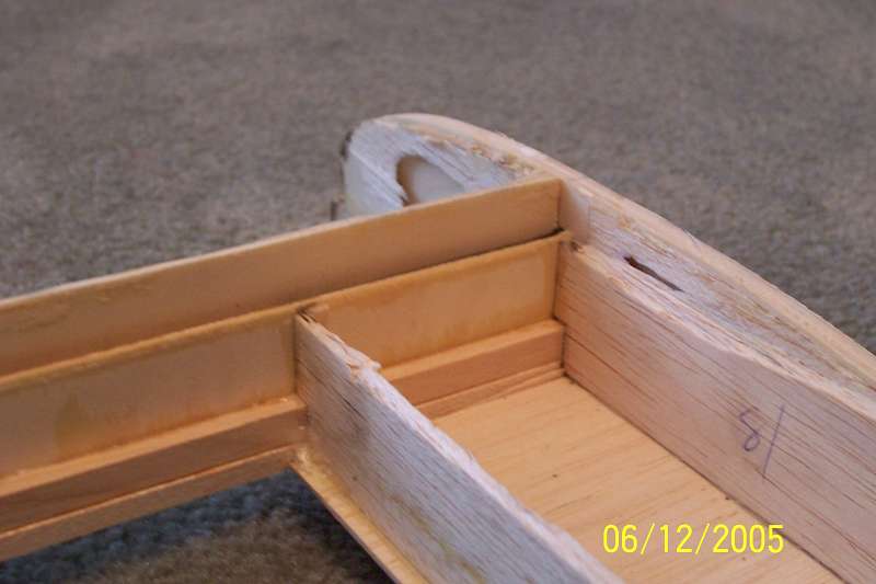

I recently took a workshop at the local hobby store where they helped newbies get into the hobby relatively cheap and offered all the help with assembling and learning to fly a Sig Kadet Senior. I was out with the instructor on Friday and everything was going fine, flying the pattern learning the controls when the left wing just failed, it snapped and down came the plane. This is all new to me and I was not flying extreme[img][/img][img][/img] or was I at full power my half stick. Needless to say the plane hit the ground and is now in several pieces I asked the instructor what happened and he said he didn’t know the wing may have had some damage all along and it just broke at the weak point. If I contacted sig and explained what happened do you think they would replace the aircraft or do I just bite the bullet and start over?

the wing did not break where they come together it broke out about 1/2 to 3/4 towards the wing tip

after getting the parts out and looking them over the wing broke at the point where the spar stops inside the wing " It did not break at where the 2 wings meet.

The spar stops ? Do you mean webbing ? The spar usually goes the entire length of the wing. There can be two spars, an upper and lower. And they can be connected by a piece of wood called a web.
But if you mean the wing broke where the dihedral brace ends, then that is a problem. That would indicate that it was not properly glued. But Sig might not see it that way. Sig may not even care. They still might replace the kit.

i bet he means the were the ply doubler ends(that would be about 3/4 in to the center) .

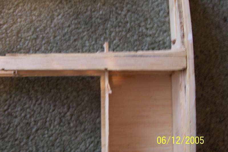

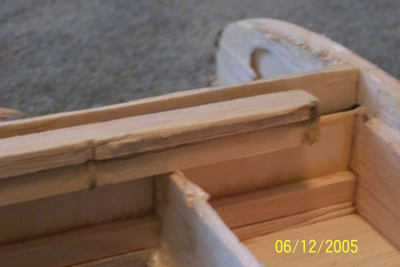

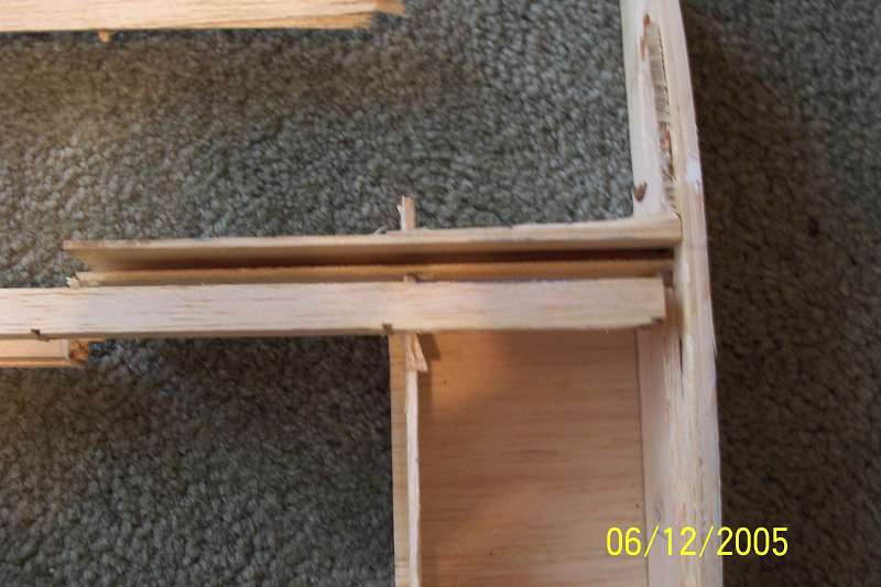

attached are several photos of where I believe the wing failed...it looks like the joint was not clued or not clued correctly because of such a clen break or seperation. please give me your input on these photos...thanks to all of you have have left comments.

Call Sig tomorrow and tell them what happened, and send them the pictures if need be. I think that you will find that Sig is a very reputable company and they will do what is right in this matter. From the pictures it looks like the wing failed. This happens sometimes. I'm pretty sure they will replace your plane. I doubt the will replace the motor though. It is rare that a motor is actually damaged in a crash. Usually a good cleaning to get the dirt out of it is all that is needed. It should be fine after you clean it.
