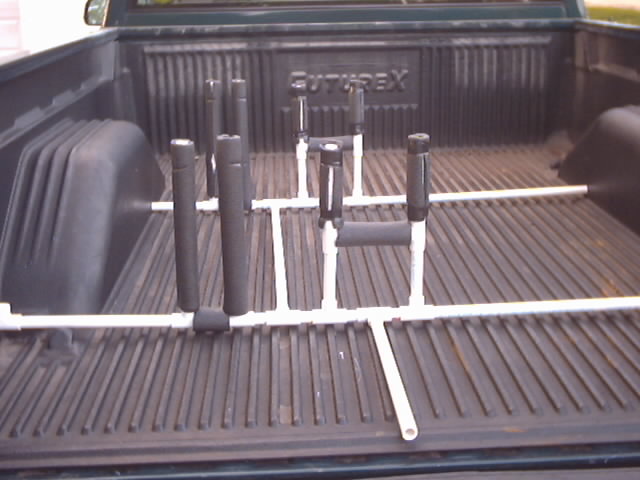

Nubie, I'd be interested in seeing your custom made plane holder for your truck. If you're able to post a pic, that would be great.

This is the picture of the pvc holder I did but it is not my design totally I did a search on RC and found some others who did this and custom made it for my plane and truck bed its 1/2 pvc with wrap for where the planes pieces sit and the bungee cords are for going over the body of plane and wrap around the poll to keep it in place the wing goes in the tall pieces of pipe and a small bungie wrapped around the top keeps it from going anywhere. This was my first outing and first flight today I had to go 30 miles one way and 55 most of the way and everything rode great. The two flights I had today with an instructor went great did my left hand turns and then right turns and figure 8 today and some 40 foot runway passes to get the feel for landings.

OH NO! I see an addict in the making that is a great idea on the carrier love it

I did almost a year of research on RC and talking and going to fun flies and things before jumping with both feet I have but not completely finished the Billy Flight Box from Hell made from a stanly two wheel and raised handle with all the goodies for going to the flight area and truck bed plane holder so addict yes its all but here. All this to just have one plane to train with but im sure my addiction will be a long history. I did the pvc for this plane to one side so that in hopes when i can get a second and just add it in with a few snips of pvc yes some months away but I like to plan for the future.
