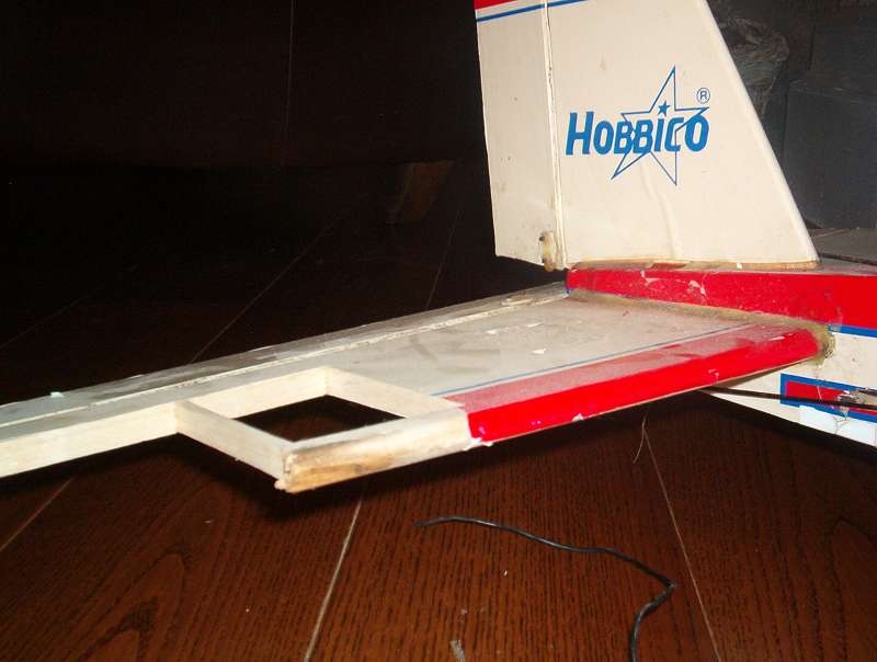

About 2 years ago, I was given by a friend an old style Avistar (red and white mono), with an O.S. .40FP and an old Futaba system. The engine and radio were junk (replaced the engine with a .46LA and the radio with a Futaba 4YF, then a Hitec Eclipse), but the airframe seemed fairly solid. Aside from a few small holes in the the wing, which I patched with stick-on Ultrakote, the airplane seemed to be in relatively good shape. However, a more through inspection revealed a couple of glaring problems. The tail end of the fuse (about 2 inches in front of the vertical stab) has a crack in the wood about 3 inches long, allowing the tail to twist and bend quite a bit, and I'm fairly sure it wouldn't hold up in flight. A bit of the wood in the tail was fuel soaked (for several years, apparently). The leading edge of the right-corner of the horizontal stab fell completely off due to this. Even without these problems, I'm hesitant to put a new engine and radio system into an older plane that sat in someone else's attic for at least 5 years, and my findings only magnify these fears. So basically, my question is this: Should I attempt to repair this plane and fly it, or put the radio gear and engine into a new airframe?
Also - Which type of epoxy is best used for constructing planes, and where is it readily availible? (i.e. can I use the kind they sell at Wal-Mart)

for the crack, i think i would just put a backing piece epoxied to the back. im not shure if you couldnt make a joint and stick on a new piece of leading edge there, but ill leave that to the guys who have fixed that issue before.

Ice_man - The fuel soaked wood seems to be only in the right side of horizonal stab, part of which broke off at the glue joint. The crack isn't as bad as I thought, it runs about half an inch from the opening for the control rod. I enclosed a couple more pics that show it in more detail.

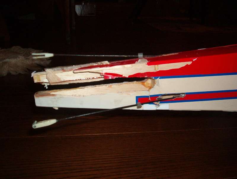

Well...thought I'd give an update. I decided to try to rebuild the tail section. When I did this, I discovered another crack in the wood. This one ran about 2 inches long on the right glue joint of the vertical stab. So, I set to removing the tail feathers. This went well...tail feathers came off....but not before breaking in several places and taking a good chunk of the right rear of the fuse along with it[:@]. So, uhh...what now?

Actually, the damage you have there isn't really bad at all. Hopefully you saved all of pieces of the fuselage. You can use epoxy or thick CA to reglue those pieces back to the fuselage. Once they are back in place you can epoxy some popsicle sticks inside the fuselage over the joints to strengthen them up. For the horizontal stabilizer you can reglue the big parts together with thick CA, then use balsa to rebuild the part that was missing. You should be able to glue the pieces of the vertical stabilizer back together with thick CA too. Then use 30 minute epoxy to glue the tail feathers back to the fuselage. It may not come out looking perfect, but you can definately get his plane back in the air. Just take a deep breath and relax, you can get this back together.
Hope this helps.

Well...I took the plane up the road to Ben's, and Jim gave it a pretty through looking-over, and discovered that the nose is heavily fuel soaked as well. He also said that rebuilding the tail would add a considerable amount of weight to the tail, and make the plane more difficult to fly than it should be. So, I decided to start fresh and bought an Alpha ARF. So far, the assembly seems to be pretty straight-forward, but I have a few questions. When joining the wing, making sure to add in the 5 inches of dihedral, what can I use to support the wing, since it will not sit level due to the aileron rod? Also, the wheels do not rotate freely on the axles. How can this be fixed?
