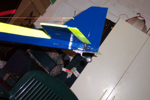

I don't know about your particular model, but I have had success with mine which is a Nova 40. On my particular bird both the nosewheel and main gear were pathetic, and so I replaced the pair. First I used a triangular piano wire main gear, locating the axel equal with the leading edge, and then mounted an off the shelf tail wheel assembly on the tail.
On the mainmount, I installed extra plywood in the floor for mount points, and then just used d clamps to attach. Works really well.
For the tail wheel, the one I purchased mounts on the tail with a wire that I attached to the rudder. It allows good steerage, and I did not have to run any more control rods.
Here are a couple of pictures of my setup ... all has performed well, I did have to replace my tailwheel once, but that was do to particularly hard contact with the ground, which broke allot more that my tailwheel!
Good luck ... I think the total cost of my mods was around 10 pounds.
First pick is the alignment of the main gear with the leading edge.

That is interesting. I have never seen the mains mounted that far forward. When I was setting up mine, I asked opinion on the forum and the responses I got were specific about keeping things even with the LE of the wing. Even the BTE venture that I am building now has the mains lined up even with the LE.
Have you had an problems getting the tail off the ground, or any additional wear and tear on the tailwheel with more weight resting on it? I would bet that having that far forward would really improve the ground handling characteristics.
I might have to play around with moving the mains forward for sure.
