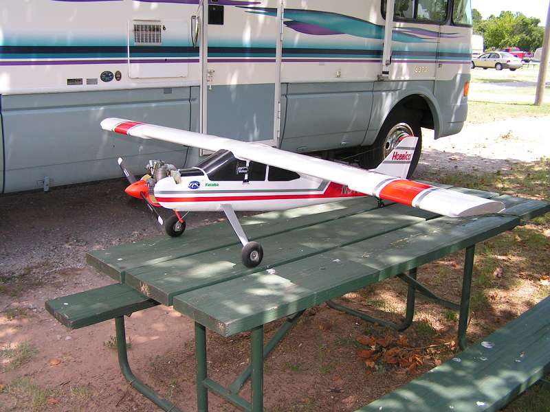

Old 07-08-2005 | 09:15 PM
Joined: Jun 2005
Posts: 165
From: Tulsa, OK
Default RE: Mile High Flying
No problem my plane goes every where with, where I go it goes.
