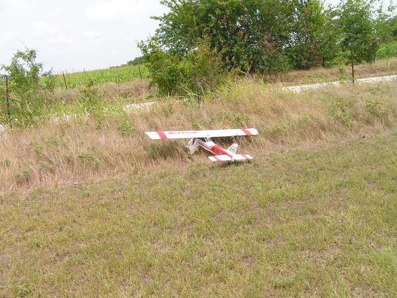

Wheels be sure to really re enforece, I landed hard yesterday and it broke all the way thru the fuse, iam really ticked. When we got there and pick it up the nose was competley off.

Chad the wings will mount flat together, if he bends the rod correctly that will work just fine, I have done more than one of these, I did have to cut the center piece out so I could use the dowel and hole for the mounting of the wing, there are pics of all of this in Nexstar problems thread.
Wheels you never spell my name correctly I hope you don't fly upside down, just kidding. Weight isn't a problem either I used 2 pieces of 1/4 ply for the landing gear.
What I don't get is why I wasn't going fast and wasn't high I had so much damage to the nose, I screwed up somewhere, as you can see in the pic above the nose is off and the engine is laying back under the wings. The balse is split under neath the fuse almost to the rear, discovered this after pulling off the covering. Tower doesn't have any in stock either. The ole saito just quit on me, we were taking slow close pics of her I was returning to the runway for another shot when she sputtered and quit, I had to try a turn so the plane would'nt hit the fence, been there done that. Just can't believe it tore the whole darn nose off.

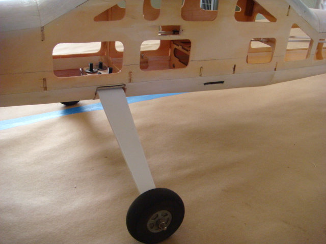

Old 04-13-2009 | 11:20 PM
Joined: May 2008
Posts: 14
From: Denver, CO
Default RE: NEXSTAR TAILDRAGGER ADVICE.....

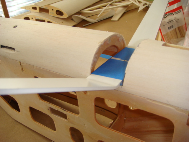

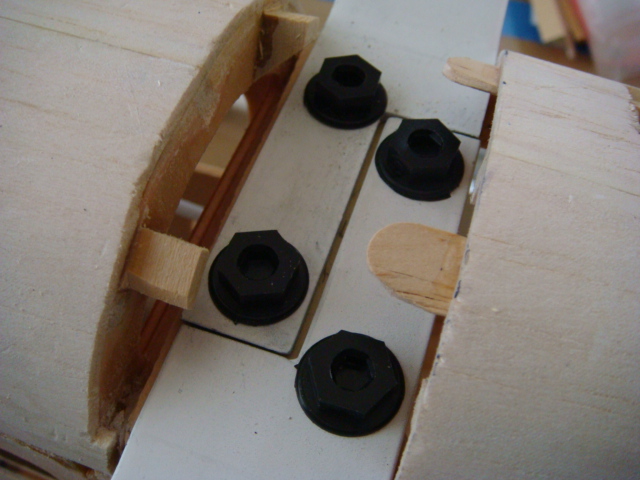

Here is how I did mine...

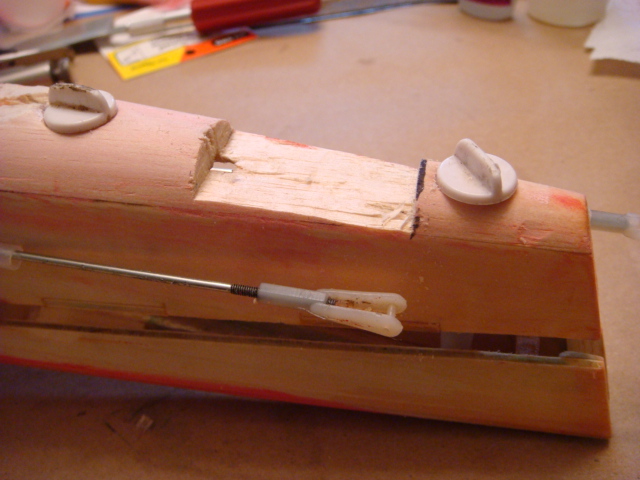

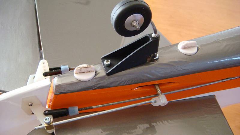

Old 04-13-2009 | 11:22 PM
Joined: May 2008
Posts: 14
From: Denver, CO

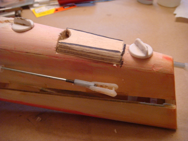

Here is the tail details...

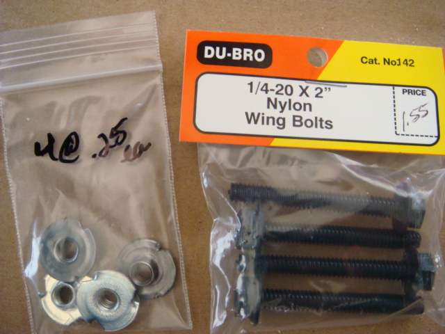

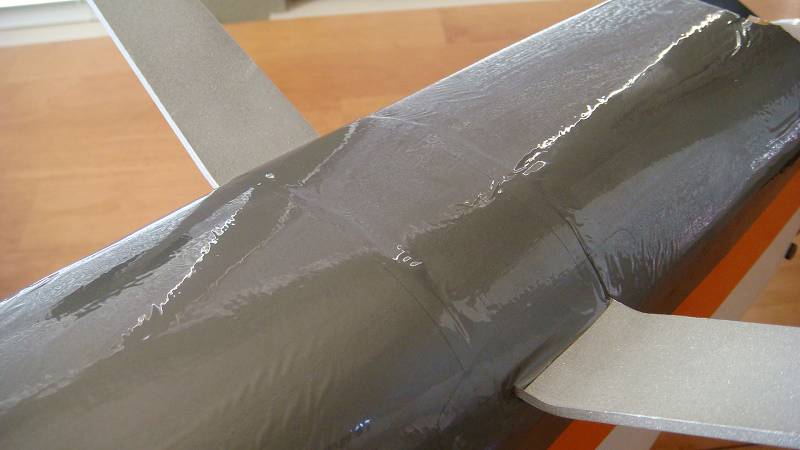

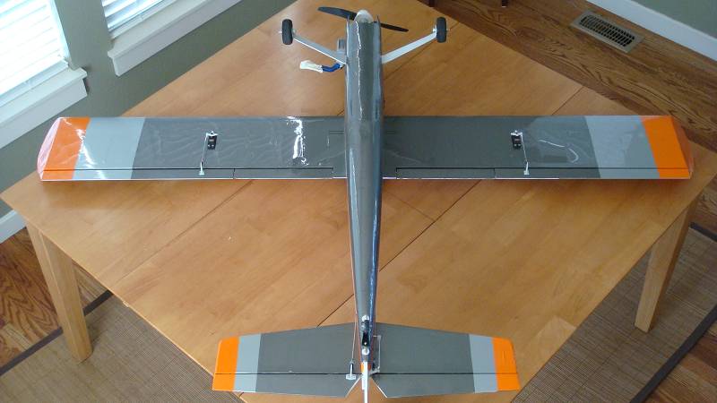

Old 04-13-2009 | 11:32 PM
Joined: May 2008
Posts: 14
From: Denver, CO
Finished look. I had to move the battery & reciever far forward to rebalance the plane. So far it seems to be OK. I did come up short of the runway on the first landing and the plane hit the grass. One of the main gear halves was ripped off, but the nylon wing bolts did their job to sacrifice themselves to save the structure. All I had to do was replace two bolts, and place a new covering patch over that area. There was already a slot cut in the rear tail section where I bent the tail dragger steering arm to come out through that opening. I then soldered a threaded sleeve onto the steering arm, connected a horn onto it, and then linked it to the rudder control horn.
