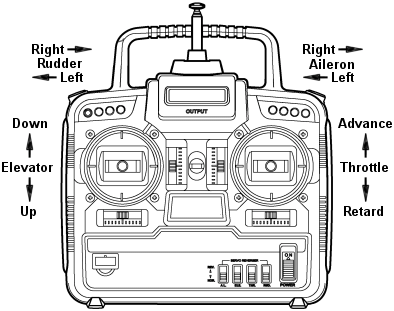

MODE 1 HAS THE ELEV ON THE LEFT STICK AND THE THROTTLE ON THE RIGHT STICK. THERE ARE SEVERAL OTHER MODES AVAILABLE BUT THESE ARE THE MOST COMMONLY USED IN THE US.
MODE 1 IS VIRTUALLY A SPECIAL ORDER ITEM THESE DAYS IN THE US, BUT AVAILABLE.

There is an article on my web page that explains how a radio works, [link=http://webpages.charter.net/rcfu/HelpsHints/RadioOps.html]Radio Control System Operation[/link]. It explains Mode I and Mode II and give an overview of how a porportional system works.
